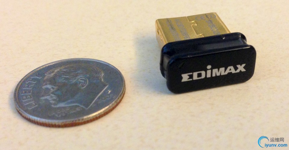

  I’m writing this blog to help anyone with an Edimax Nano USB WiFi adapter (EW-7811Un) configure a Wireless Accesss Point. The main reason I wrote this post is because the Edimax was the first wireless adapter I ever recommended(turning a Raspberry Pi into a fully functional web server). I chose this adapter because it works out of the box, is cheap, and has a really low profile. But when I started the process of trying to turn my rPi into a WiFi hotspot, it seemed that every tutorial out there claimed that the Edimax card I had recommended “doesn’t support Access Point”.
  Luckily for you and me, this is not the case.

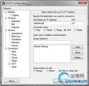

  After the image is flashed, you can boot your device. At this point you can use your HDMI Cable/Mouse/Keyboard for your initial configuration, or you can use an SSH Client like Putty to connect. The default hostname, login, and password are as follows:
  host:raspberrypi
Username: pi
Password: raspberry

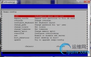

  For this tutorial, I will be using putty. On first boot, you will be prompted with a configuration tool called Raspi-Config. If the raspi-config doesnt load automatically, just enter the following command from the shell to get started.
sudo raspi-config
  The settings I recommend you update are
  update
expand_rootfs
change_pass
change_timezone
memory_split
  The usual distribution images are 2 GB. When you copy the image to a
larger SD card you have a portion of that card unused. expand_rootfs
expands the initial image to expand to fill the rest of the SD card,
giving you more space. By default, 64mb is reserved for the Graphical
UI. Since we plan on using this as a WiFi Hotspot, we can reduce this to
32mb with the memory_split command.

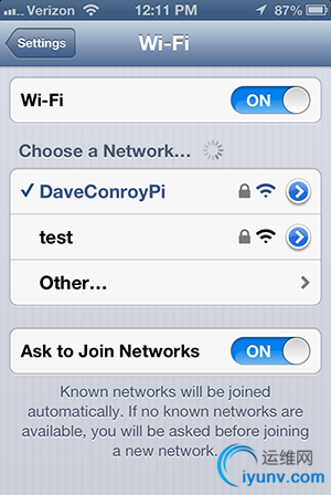

  We should be finished now, and afer a reboot
sudo reboot
  you can test your configuration using the following command
sudo hostapd -dd /etc/hostapd/hostapd.conf
  If it runs as expected, you can add it to startup by editing
sudo nano /etc/default/hostapd
  and uncommenting and updating the following line
  DAEMON_CONF="/etc/hostapd/hostapd.conf"
  That should do it! I’m happy to answer any questions, just comment on this post. Thanks for reading! DSC0004.png
