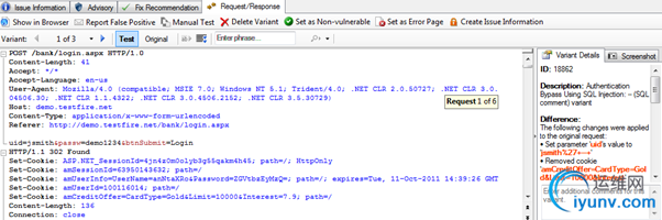

  Request/Response
  This is most significant tab, with specific details about the requests which were sent to the application as part of the tests and the responses associated with them. So within a single test, Appscan might send more than a single request, depending on the issue. For instance, to check a blind SQL injection vulnerability, first the Appscan sends a normal request and records the response. Then it sends an injected parameter as a part of the request, which is a true condition, and records the response. Similarly it sends another request to check the false condition. The malicious payloads will be highlighted in order to differentiate from the others. So for most of the time you will be working in this tab mainly to understand whether the reported vulnerability is a false positive or a valid finding. Under this tab there are a few more options available as shown in the figure below.
  Show in Browser – Allows you to see the response in the browser. For instance, if you are viewing a cross site scripting vulnerability in the browser, it actually reflects the alert message which was sent by the Appscan.
  Report False Positive – If you find an issue which is to be reported as a false positive to Appscan Support team you can click on this option. Note that this option is not for marking it as a false positive, but for reporting an issue to the Appscan team.
  Manual Test – Upon clicking this option, a new window opens and allows you to modify the request and send it to observe the response. This is somewhat similar to the ‘repeater’ option in Burp Suite.
  Delete Variant – This will delete it permanently from the results.
  Set as Non-vulnerable – The selected variant will be considered as non-vulnerable.
  Set as Error Page – Sometimes the application returns a customized error page. By selecting this option here, Appscan will consider all the responses of that type as error pages. Otherwise there is a chance that they might be treated as valid pages because of the 200 OK responses.
  The ‘Variant Details’ tab highlights the changes that were applied to the original request.

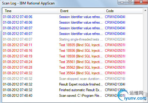

  Scan Log records every action performed by Appscan (refer to the figure below). So using this feature, you can track all the activities. For instance, while the scan is running you can view precisely what the Appscan is looking for.

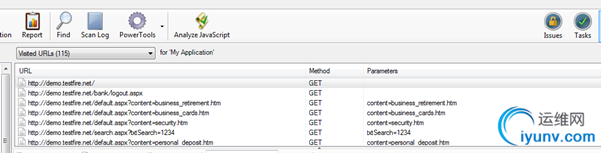

  You can view various other results under View Application Data. This shows the visited URLs, broken links, JavaScript, cookies, etc.

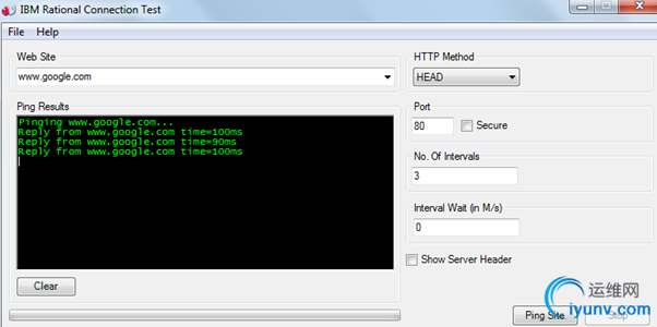

  Connection Test
  This can be used to ping a website, and nothing more. Ping protocol might be blocked by many protocols and this is where you can use it.
