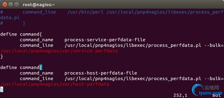

    2.3 修改commands.cfg文件
vim  /usr/local/nagios/etc/objects/commands.cfg
10
11
12
13
14
define command{
       command_name    check_nrpe
       command_line    $USER1$/check_nrpe-H $HOSTADDRESS$ -c $ARG1$
define command{
       command_name    process-service-perfdata-file
       command_line    /usr/local/pnp4nagios/libexec/process_perfdata.pl --bulk=/usr/local/pnp4nagios/var/service-perfdata
define command{
       command_name    process-host-perfdata-file
       command_line    /usr/local/pnp4nagios/libexec/process_perfdata.pl --bulk=/usr/local/pnp4nagios/var/host-perfdata
