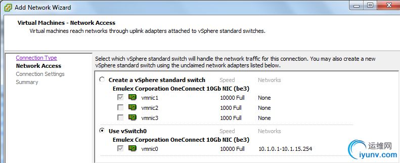

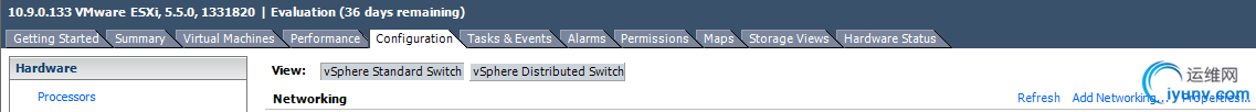

  新建一个br-int(虚拟机挂载的虚拟桥)
  create a network port group named "br-int" in ESXI driver with vSphere client on the network configuration items.
  (1). Click "Configuration" item on ESXI with the vsphereclient
  (2). Click "Add networking", Choose "Virtual machine" , then "Next"
  (3). Create or choose the default switch , then "Next"
  (5). Fill the "Port group properties"
