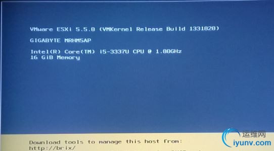

After running the commands above PowerCLI will start downloading the offline bundle from VMware.com and then write the ISO file to your selected destination.
Next, I used Unetbootin to write that ISO file to a USB stick, and then booted from the USB stick to install ESXi 5.5.
