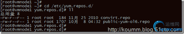

(2)准备convirt安装源
12#cd /etc/yum.repos.d#wget --no-cache http://www.convirture.com/repos/definitions/rhel/6.x/convirt.repo DSC0000.gif

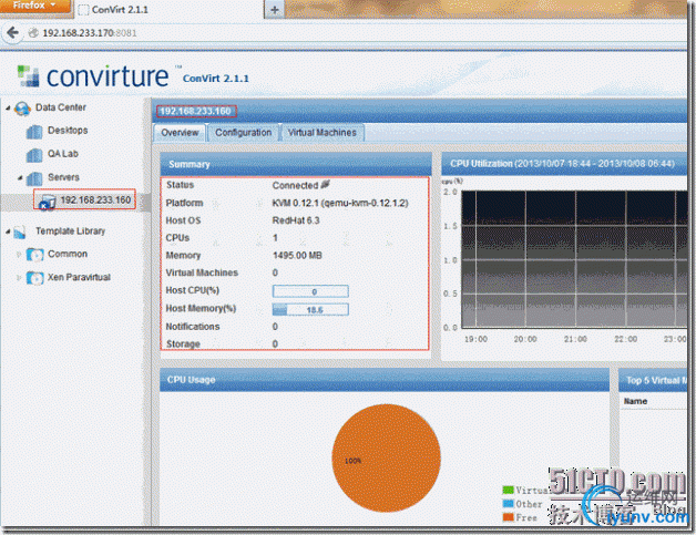

http://192.168.233.170:8081
输入admin/admin
还需要在kvm虚拟主机上安装convirt-tools工具之后才能添加。

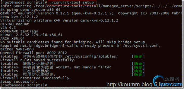

2.在KVM虚拟主机上安装convirt-tools工具
注:在kvm虚拟主机上安装convirt-tools工具。
12345#wget http://www.convirture.com/downloads/convirture-tools/2.1.1/convirture-tools-2.1.1.tar.gz#tar zxvf convirture-tools-2.1.1.tar.gz#cd convirture-tools/install/managed_server/scripts#./convirt-tool install_dependencies#./convirt-tool setup DSC0009.gif

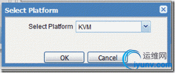

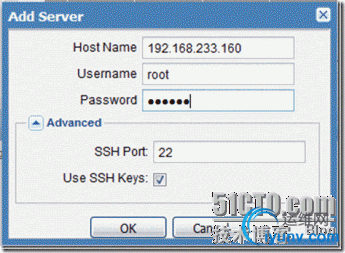

3.在convirtcms上添加KVM虚拟主机
添加KVM虚拟主机。
