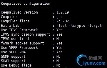

三、编译Keeplived
# tar -zxvf keepalived-1.2.19.tar.gz
# cd keepalived-1.2.19
# ./configure --sysconf=/etc --prefix=/usr/local/keepalived
# make
# make install

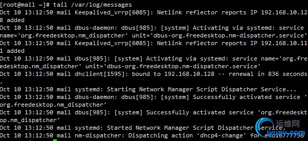

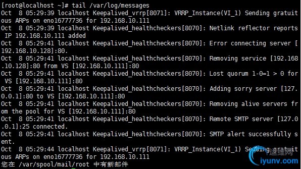

④查看系统日志
# tail /var/log/messages
注:这是192.168.10.145的日志(没有同步时间),由于更改配置后没有重启Master,所以BACKUP进行了抢占
Master:
# systemctl restart keepalived.service
# ip addr

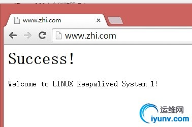

五、测试
浏览器输入www.zhi.com测试

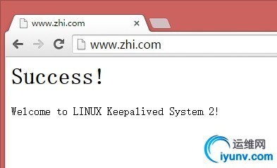

Master:
# nginx -s stop

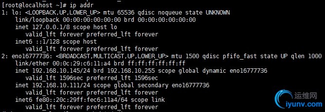

BackUp:
# ip addr
虚拟IP地址已切换至备机了
刷新www.zhi.com,可能反应较慢
