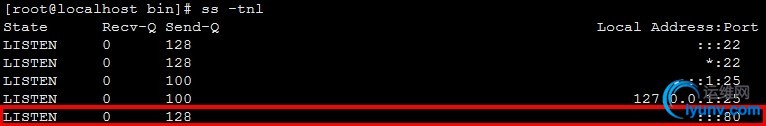

        第七步:启动服务,并且测试。
[iyunv@localhost bin]# service httpd start
httpd (pid 35925) already running
[iyunv@localhost bin]# ss -tnl
