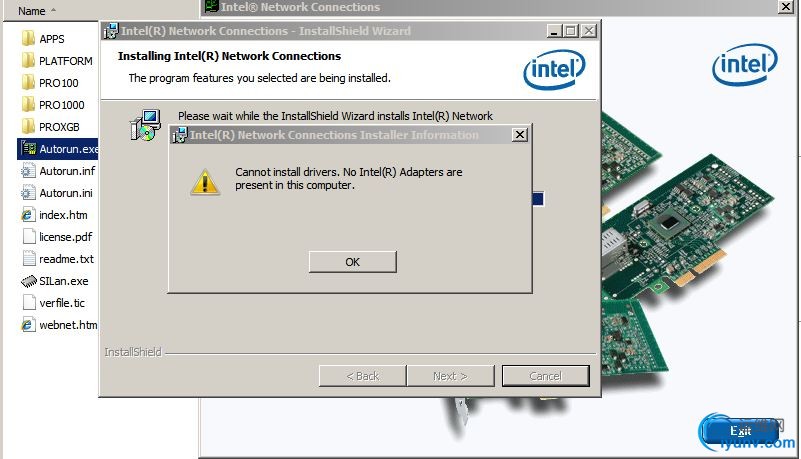

With the 82579V I got a failed installation that told me: “Cannot install drivers. No Intel® Adapters
are present in this computer.”
That was a problem for me since I was planning to use the 2nd NIC
on the Motherboard for my Hyper-V machines. I posted an error report on Gigabytes Technical Board several days ago and am awaiting a reply.

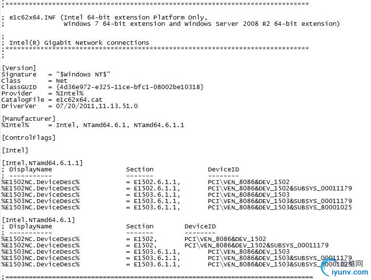

  • Open file e1c62x64.inf with Notepad (interestingly when you open it you will see that the file e1c62x64.inf is commented
    at the beginning that it is for Windows 7 and Windows Server 2008-R2)

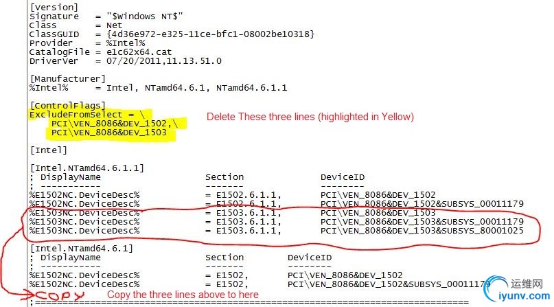

  • The first thing you will need to change in the .inf file is the [ControlFlags] section – I deleted all 3 lines of that section following the section header so that all was
    left was the section header [ControlFlags] – I left a blank line after [ControlFlags] which then leaves the [Intel] section next.
  • At the [Intel] section, the [Intel.NTamd64.6.1] relates to Server 2008R2 and the [Intel.NTamd64.6.1.1] relates to Windows
    7; you can see that the three E1503 lines in the Windows 7 section are missing from the server section, I copied/pasted those three lines from the Windows 7 section to the bottom of the 2008R2 section.
This is what e1c62x64.inf looked
like before I made any changes:
like after I made my changes:
I then saved the e1c62x64.inf file
and then backed out of folders until I was in the sub-folder Intel_Mod where I double clicked
Autorun.exe to
install the drivers for the Intel 82579V.

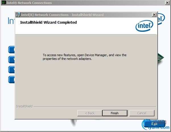

Driver installation went very well and ended successfully.
This solved my issue of being to use my 2nd NIC on my Z77 for my Hyper-V server.

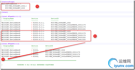

  • Open the e1c63x64.inf file, I used Notepad++  to edit the file

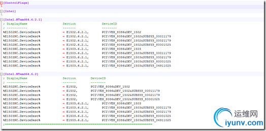

  • In the [ControlFlags] section delete the 3 lines (1)
  • Select and copy the five %E1503 lines (2)
  • Paste the 5 lines in the [Intel.NTamd64.6.2] section below the %1502NC lines
  • After the modifications the e1c63x64.inf file must look like this:
  • Save the file
  • Install the Intel drivers

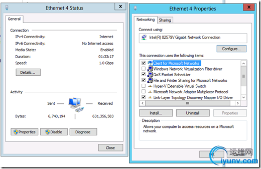

  • After the installation the Intel 82579V Gigabit NIC is recognized and enabled
