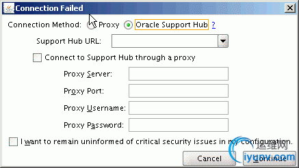

3.2.2.3 No Direct Connectivity to Internet - Using Oracle Support Hub
  If you do not have direct connectivity to the Internet, use the Oracle Support Hub.
  •   If you cannot access the Oracle Support Hub specified or you entered NONE, you are prompted for the proxy server.
    •   Either enter a proxy server or type NONE.
    •   If you entered NONE for both Oracle Support Hub and proxy server, Oracle Configuration Manager is configured in disconnected mode.
  •   If you specified a proxy server but you still cannot access Oracle, you will be prompted for Oracle Support Hub again.
    • Supply the URL for the Oracle Support Hub or type NONE.
  You will be prompted for Oracle Support Hub and possibly proxy server until there is connectivity to Oracle or you type NONE for both the Oracle Support Hub and proxy server.

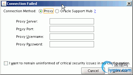

3.2.2.4 No Direct Connectivity to Internet - Using a Proxy Server
  After the file has been unzipped, install and complete the configuration of Oracle Configuration Manager by entering the following command from the <ocm_install_root>/ccr/bindirectory:
setupCCR [-s] [[<CSI>] [<MyOracleSupportUserName>] ]
Note:
When you set up Oracle Configuration Manager in Connected mode and you want to register using the Customer Support Identifier (CSI), youmust specify at
least the CSI on the command line. If the CSI is not specified on the command line, you will be prompted for credentials. If you do not specify correct credentials in three tries, unauthenticated mode will be used.  To install and complete the configuration of Oracle Configuration Manager using a proxy server, do the following:
  •   If you do not have direct access to the Internet and you do not have access to an Oracle Support Hub, type NONE at the prompt for the Oracle Support Hub.
  •   Specify the host, port, and authentication information, if required, for the proxy server. The format is as follows:
    [<proxy-user>@]<proxy-host>:<proxy-port>
  •   If you specify a proxy server but you still cannot access Oracle, you will be prompted for a proxy server until you type a correct proxy server or you type NONE.
  Note the following:
  •   If the proxy-user is specified, you will be prompted to enter the password.
  •   If the proxy-user is not specified (<proxy-host>:<proxy-port>), a proxy server will be used for the connection, but will not be authenticated.
  •   If a default proxy-port is to be used, any of the following is a valid proxy string:
    <proxy-host>
    <proxy-user>@<proxy-host>
  See &quot;Using Both Oracle Support Hub and Proxy Server (In Connected Mode)&quot; for an example using proxy information.

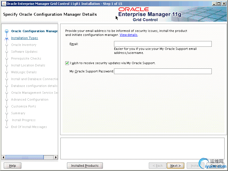

  <ocm_install_root>/ccr/bin/setupCCR
Provide your email address to be informed of security issues, install and
initiate Oracle Configuration Manager. Easier for you if you use your My Oracle Support
Email address/User Name.
Visit http://www.oracle.com/support/policies.html for details.
Email address/User Name: ssmith@example.com
Provide your My Oracle Support password to receive security updates via your My Oracle Support account.
Password (optional):

3.3 Installing Oracle Configuration Manager Using the Oracle Universal Installer
  Oracle Configuration Manager may be bundled with another product release or patchset, and can be installed using the Oracle Universal Installer. When you are installing the product release or patchset with which Oracle Configuration Manager has been included, Figure
3-1 is displayed.
Figure 3-1 Oracle Configuration Manager Registration Screen
3.3.1 Providing Credentials
  When you provide both the e-mail address and password, Oracle Configuration Manager checks for connectivity to verify the credentials specified. If there is no direct connectivity to Oracle, the Connection Failed dialog box appears with the Proxy connection
method selected (Figure 3-2). If you want to configure Oracle Configuration Manager to connect to Oracle
using an Oracle Support Hub, you must select the Oracle Support Hub radio button (Figure 3-3). Either of
these methods enable you to define a connection to Oracle.
  If no connection is possible, check the I want to remain uninformed of critical security issues in my configuration check box on the Connection Failed dialog box. This causes Oracle Configuration Manager
to be installed in disconnected mode.
  Once connectivity is established, the credentials are verified. You are given three opportunities to enter correct credentials. After the third failure, you will no longer be prompted and Oracle Configuration Manager will be configured in unauthenticated
mode.
  You must supply at least the e-mail address. Oracle Configuration Manager is configured in unauthenticated mode.
3.3.1.1 Connection Settings Using Proxy Server
  The Connection Failed dialog box, with Proxy connection method selected (Figure 3-2), appears when Oracle
Universal Installer determines there is no connectivity to Oracle.
Figure 3-2 Connection Failed - Proxy Method
Description of &quot;Figure 3-2 Connection Failed - Proxy Method&quot;
  To configure Oracle Configuration Manager to use a proxy server, enter the following details.
  On the Connection Failed dialog box:
  •   Enter the host name of the proxy server. For example, you can specify the proxy server setting as follows:
      Proxy Server: www-proxy.example.com
  •   Enter the port number of the proxy server. For example, you can specify the proxy port as follows:
      Port: 98
  •   If the proxy server requires authentication, you must specify the credentials in the Proxy Username and Password fields.
  •   Click Continue to verify that you can connect to Oracle.
    •   If the connection is not successful, you remain on the Connection Failed dialog box. Either enter correct proxy server information or, if no connection is possible, check the I
      check box. Oracle Configuration Manager will be installed in disconnected mode.
    •   If the connection is successful, Oracle Configuration Manager validates the My Oracle Support User Name (e-mail address) and My Oracle Support Password. SeeSection
      3.3.1, &quot;Providing Credentials&quot; for additional information.
Note:
NT LAN Manager (NTLM) proxy server settings are not supported.
3.3.1.2 Connection Settings Using Oracle Support Hub
  When Oracle Universal Installer determines there is no connectivity to Oracle, you can choose the Oracle Support Hub connection method (Figure
3-3).
Figure 3-3 Connection Failed - Oracle Support Hub Method
  Enter the Oracle Support Hub configuration details as follows.
  •   Choose the appropriate Oracle Support Hub from the Existing Oracle Support Hub URL drop-down list or enter the URL for the Oracle Support Hub, for example, http://host123.example.com:8888.
  •   Decide whether you need to connect to the Oracle Support Hub by way of a proxy server. If so:
    •   Check the 'Connect Using Proxy Server' box.
        Port: 98
    •   If the proxy server requires authentication, you must specify the credentials in the Proxy Username and Proxy Password fields.
    •   Click Continue to validate that you can connect to Oracle.
      •   If the connection is not successful, you remain on the Connection Failed dialog box. Either enter the Oracle Support Home URL or, add or correct the proxy server information. If no connection is possible,
        check the I want to remain uninformed of critical security issues in my configuration checkbooks. Oracle Configuration Manager will be installed in disconnected mode.

3.5 Installing Oracle Configuration Manager on Enterprise Manager
  During the installation of Enterprise Manager, Oracle Configuration Manager is installed in the Enterprise Manager Oracle Home and configured to run from the Enterprise Manager Instance Home. If My Oracle Support credentials were not provided during the
Enterprise Manager installation, Oracle Configuration Manager can be installed manually by doing the following:
  •   Set the variable ORACLE_CONFIG_HOME to the Enterprise Manager Instance Home.
  •   From the Enterprise Manager ORACLE_HOME, execute the setupCCR command and provide the My Oracle Support credentials when prompted.
