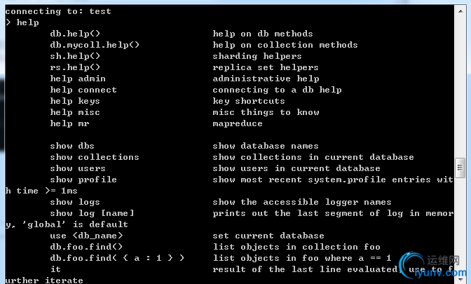

shell连接到MongoDB
  mongo shell下键入help查看可用命令的列表及其描述
  例如查看DB的方法db.getName()

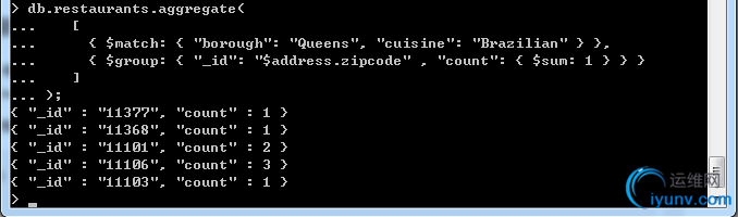

使用$match过滤文档,语法和查询操作语法一样。下面例子过滤出borough等于Queens和cuisine等于Brazilian的文档作为$group的输入,然后按address.zipcode的&#20540;进行分组和统计
db.restaurants.aggregate(
{ $match: { &quot;borough&quot;: &quot;Queens&quot;, &quot;cuisine&quot;: &quot;Brazilian&quot; } },
{ $group: { &quot;_id&quot;: &quot;$address.zipcode&quot; , &quot;count&quot;: { $sum: 1 } } }
);结果集由以下文档构成

public void aggregation(){
//1、按字段borough值分组然后,使用累加器统计每组文档个数,$group的字段需要$前缀
//AggregateIterable<Document> iterable = collection.aggregate(asList(
//new Document(&quot;$group&quot;, new Document(&quot;_id&quot;, &quot;$borough&quot;).append(&quot;count&quot;, new Document(&quot;$sum&quot;, 1)))));
//2、过滤出borough等于Queens和cuisine等于Brazilian的文档作为$group的输入,让你按address.zipcode的值进行分组和统计
new Document(&quot;$match&quot;, new Document(&quot;borough&quot;, &quot;Queens&quot;).append(&quot;cuisine&quot;, &quot;Brazilian&quot;)),
new Document(&quot;$group&quot;, new Document(&quot;_id&quot;, &quot;$address.zipcode&quot;).append(&quot;count&quot;, new Document(&quot;$sum&quot;, 1)))));
iterable.forEach(new Block<Document>() {
@Override
public void apply(final Document document) {
System.out.println(document.toJson());
