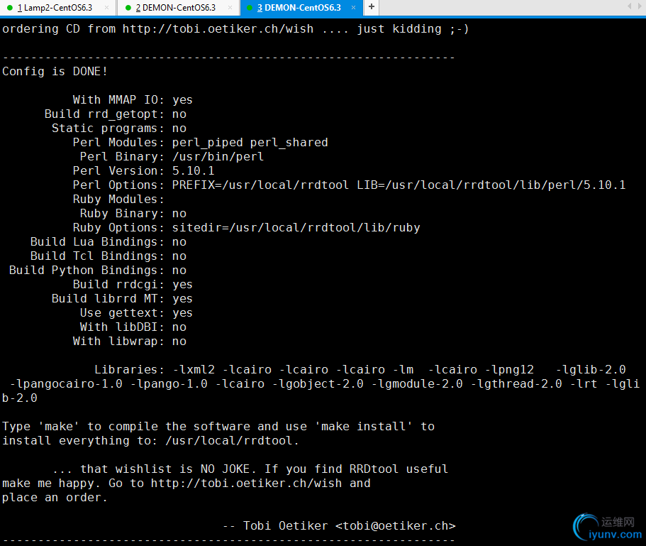

  # ./configure --prefix=/usr/local/rrdtool
  报错:
  configure: WARNING:
* I could not find a working copy of pangocairo. Check config.log for hints on why
  this is the case. Maybe you need to set LDFLAGS and CPPFLAGS appropriately
  so that compiler and the linker can find libpangocairo-1.0 and its header files. If
  you have not installed pangocairo, you can get it either from its original home on
     http://ftp.gnome.org/pub/GNOME/sources/pango/1.17
  You can find also find an archive copy on
     http://oss.oetiker.ch/rrdtool/pub/libs
  The last tested version of pangocairo is 1.17.
       LIBS=-lm
   LDFLAGS=
  CPPFLAGS=
checking for xmlParseFile in -lxml2... yes
checking libxml/parser.h usability... yes
checking libxml/parser.h presence... yes
checking for libxml/parser.h... yes
configure: error: Please fix the library issues listed above and try again.
  通过对编译出来的信息分析,包括一些警告信息,主要是因为缺少相应的库文件,解决办法:
  # yum install pango* -y
  再次编译执行:通过了,如下:

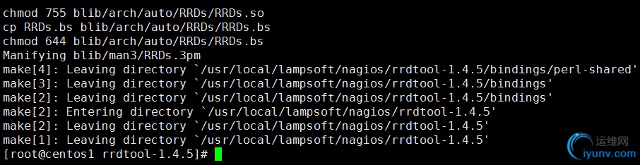

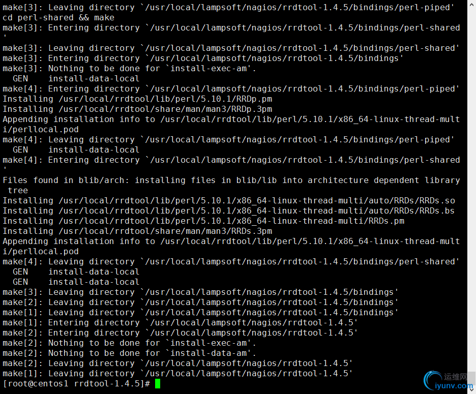

  # make
  编译有报错:
  Can't locate ExtUtils/MakeMaker.pm in @INC (@INC contains: /usr/local/lib64/perl5 /usr/local/share/perl5 /usr/lib64/perl5/vendor_perl /usr/share/perl5/vendor_perl /usr/lib64/perl5 /usr/share/perl5 .) at Makefile.PL line 1.
BEGIN failed--compilation aborted at Makefile.PL line 1.
make[3]: *** [perl-piped/Makefile] Error 2
make[3]: Leaving directory `/usr/local/lampsoft/nagios/rrdtool-1.4.5/bindings'
make[2]: *** [all-recursive] Error 1
make[2]: Leaving directory `/usr/local/lampsoft/nagios/rrdtool-1.4.5/bindings'
make[1]: *** [all-recursive] Error 1
make[1]: Leaving directory `/usr/local/lampsoft/nagios/rrdtool-1.4.5'
make: *** [all] Error 2
  解决办法:yum -y install perl-ExtUtils-MakeMaker
  然后重新make,提示如下:
  # make install
  安装完成之后就可以安装pnp了。

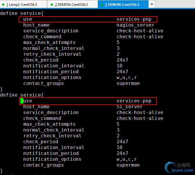

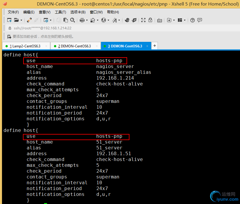

  6.修改hosts.cfg和services.cfg文件,给每个主机和服务增加小太阳标识。只需要使用use命令继承一下即可。如下:
  # vi /usr/local/nagios/etc/objects/hosts.cfg
  然后给每个需要统计图表信息的service加上services-pnp继承
  修改好以后保存退出。
