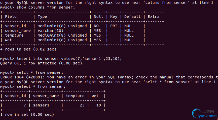

数据库测试
  打开终端,mysql –u root –p进入mysql,然后创建数据库sensers
  Create database sensers;
  选择数据库:use senserss
  创建表:
  mysql> create table senser
  -> senser_id mediumint unsigned not null,
  -> senser_name varchar(20),
  -> tempture mediumint unsigned,
  -> wet mediumint unsigned,
  -> primary key(senser_id)
  Query OK, 0 rows affected (0.14 sec)
