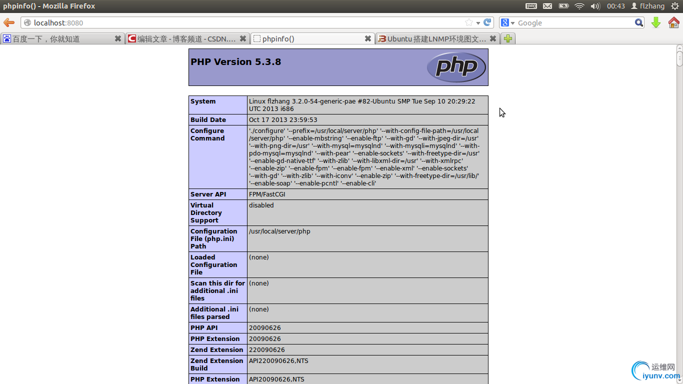

安装PHP:
  下载:wget http://cn2.php.net/distributions/php-5.3.8.tar.gz
  解压:tar zxvf php-5.3.8.tar.gz
  配置: ./configure --prefix=/usr/local/server/php --with-config-file-path=/usr/local/server/php --enable-mbstring --enable-ftp --with-gd --with-jpeg-dir=/usr --with-png-dir=/usr --with-mysql=mysqlnd --with-mysqli=mysqlnd --with-pdo-mysql=mysqlnd --with-pear --enable-sockets --with-freetype-dir=/usr --enable-gd-native-ttf --with-zlib --with-libxml-dir=/usr --with-xmlrpc --enable-zip --enable-fpm --enable-fpm --enable-xml --enable-sockets --with-gd --with-zlib --with-iconv --enable-zip --with-freetype-dir=/usr/lib/ --enable-soap --enable-pcntl --enable-cli
  途中出现如下错误:
checking libxml2 install dir... /usr
checking for xml2-config path...
configure: error: xml2-config not found. Please check your libxml2 installation.
flzhang@flzhang:~/Downloads/php-5.3.8$
解决方法:flzhang@flzhang:~/Downloads/php-5.3.8$ sudo apt-get install libxml2-dev
  重新执行:./configure --prefix=/usr/local/server/php --with-config-file-path=/usr/local/server/php --enable-mbstring --enable-ftp --with-gd --with-jpeg-dir=/usr --with-png-dir=/usr --with-mysql=mysqlnd --with-mysqli=mysqlnd --with-pdo-mysql=mysqlnd --with-pear --enable-sockets --with-freetype-dir=/usr --enable-gd-native-ttf --with-zlib --with-libxml-dir=/usr --with-xmlrpc --enable-zip --enable-fpm --enable-fpm --enable-xml --enable-sockets --with-gd --with-zlib --with-iconv --enable-zip --with-freetype-dir=/usr/lib/ --enable-soap --enable-pcntl --enable-cli
  成功如下所示:

配置nginx支持PHP:
  首先建立存放网页文件的目录,执行“mkdri /usr/local/server/www”。  然后进入到该目录中,“cd /usr/local/server/www”。
  建立一index.php
<?php
phpinfo();
修改nginx.conf:如下所示:
flzhang@flzhang:/usr/local/server/nginx$ git diff conf/nginx.conf
diff --git a/conf/nginx.conf b/conf/nginx.conf
index f73cd49..4f8c9fd 100644
--- a/conf/nginx.conf
&#43;&#43;&#43; b/conf/nginx.conf
@@ -40,10 &#43;40,13 @@ http {
#access_log  logs/host.access.log  main;
-        location / {
-            root   html;
-            index  index.html index.htm;
&#43;#        location / {
&#43;#            root   html;
&#43;#            index  index.html index.htm;
&#43;#        }
&#43;#
&#43;        root /usr/local/server/www;
&#43;       index index.html index.htm index.php
#error_page  404              /404.html;
@@ -62,13 &#43;65,12 @@ http {
# pass the PHP scripts to FastCGI server listening on 127.0.0.1:9000
-        #location ~ \.php$ {
-        #    root           html;
-        #    fastcgi_pass   127.0.0.1:9000;
-        #    fastcgi_index  index.php;
-        #    fastcgi_param  SCRIPT_FILENAME  /scripts$fastcgi_script_name;
-        #    include        fastcgi_params;
&#43;        location ~ \.php$ {
&#43;            fastcgi_pass   127.0.0.1:9000;
&#43;            fastcgi_index  index.php;
&#43;            fastcgi_param  SCRIPT_FILENAME  $document_root$fastcgi_script_name;
&#43;            include        fastcgi_params;
  重启nginx,执行“sudo /etc/init.d/nginx reload”回车,并开启PHP。打开浏览器,输入“http://127.0.0.1:8080”,如下图所示:
  好了,至此,关于LNMP的搭建已算完成了..................................
