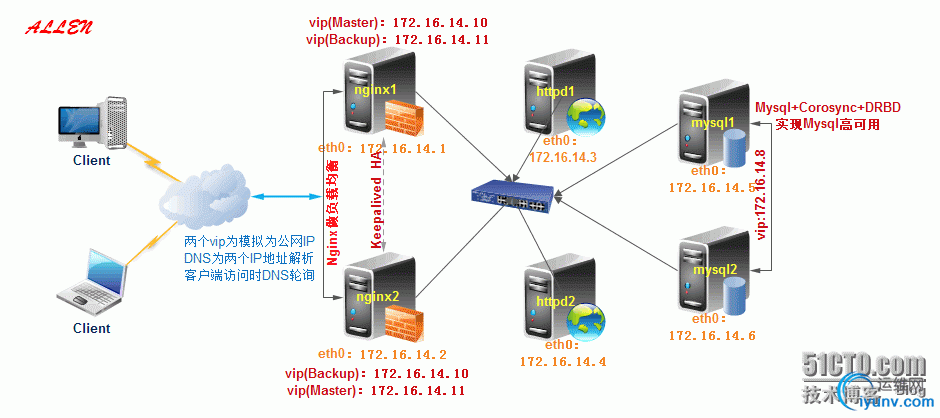

二、下面以一个案例来配置说明Keepalived+Nginx是如何实现高可用
  环境介绍:
系统版本:CentOS6_x86_64
Tengine版本: Tengine-1.5.1
Keepalived版本:keepalived-1.2.7-3.el6

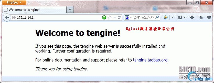

3、访问测试Nginx服务是否正常
3.1、在Nginx1服务器上测试
12[iyunv@nginx1 ~]# netstat -anpt|grep nginxtcp        0      0 0.0.0.0:80      0.0.0.0:*       LISTEN      15088/nginx DSC0001.gif

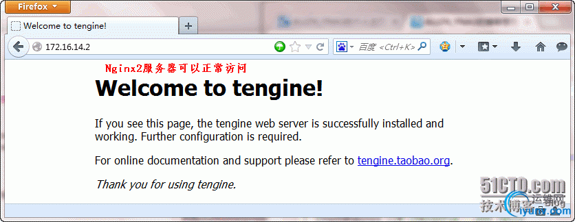

3.2、在Nginx2服务器上测试
12[iyunv@nginx2 ~]# netstat -anpt|grep nginxtcp      0      0 0.0.0.0:80   0.0.0.0:*     LISTEN 7281/nginx DSC0002.gif

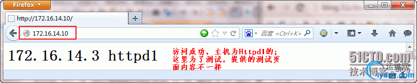

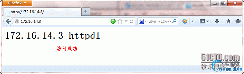

12345[iyunv@httpd1 ~]# yum -y install httpd[iyunv@httpd1 ~]# chkconfig httpd on[iyunv@httpd1 ~]# service httpd start######为Httpd1提供测试页[iyunv@httpd1 ~]# echo '<h1>172.16.14.3 httpd1</h1>' > /var/www/html/index.html DSC0003.gif

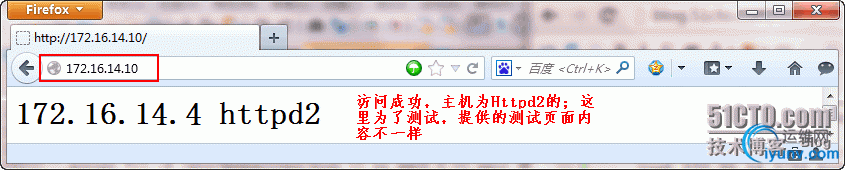

2、在Httpd2服务器配置好YUM源,使用YUM安装HTTPD服务
1234[iyunv@httpd2 ~]# yum -y install httpd[iyunv@httpd2 ~]# chkconfig httpd on[iyunv@httpd2 ~]# service httpd start[iyunv@httpd2 ~]# echo '<h1>172.16.14.4 httpd2</h1>' > /var/www/html/index.html DSC0004.gif

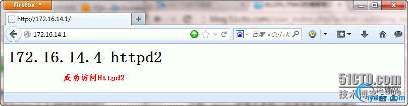

2、重启Tengine服务访问测试负载均衡
1[iyunv@nginx1 ~]# service nginx restart

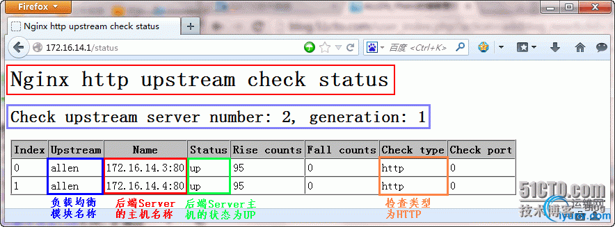

由上图可见可以成功访问到后端的Httpd服务,接下来访问测试状态监控模块

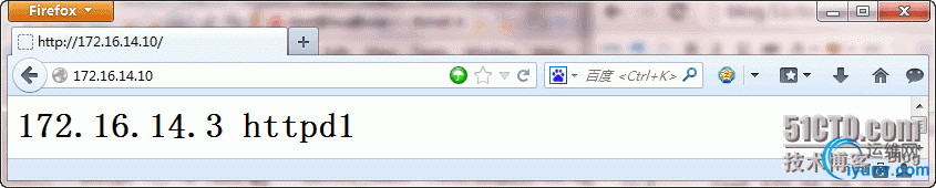

4、模拟其中一台前端Nginx服务器出现故障不能正常提供服务
12345678910111213141516171819[iyunv@nginx1 ~]# killall nginx[iyunv@nginx1 ~]# ip addr show eth02: eth0: <BROADCAST,MULTICAST,UP,LOWER_UP> mtu 1500 qdisc pfifo_fast state UP qlen 1000    link/ether00:0c:29:2c:1a:24 brd ff:ff:ff:ff:ff:ff    inet 172.16.14.1/16brd 172.16.255.255 scope global eth0    inet6 fe80::20c:29ff:fe2c:1a24/64scope link       valid_lft forever preferred_lft forever######由上可见,虚拟IP地址已删除========================================================================######在Nginx2服务器上查看IP地址[iyunv@nginx2 ~]# ip addr show eth02: eth0: <BROADCAST,MULTICAST,UP,LOWER_UP> mtu 1500 qdisc pfifo_fast state UP qlen 1000    link/ether00:0c:29:ec:f6:3f brd ff:ff:ff:ff:ff:ff    inet 172.16.14.2/16brd 172.16.255.255 scope global eth0    inet 172.16.14.11/32scope global eth0    inet 172.16.14.10/32scope global eth0    inet6 fe80::20c:29ff:feec:f63f/64scope link       valid_lft forever preferred_lft forever注释:由上可见,虚拟IP地址已成功切换5、在Nginx2服务器查看邮件通知
12345678910111213141516171819202122[iyunv@nginx2 ~]# mailHeirloom Mail version 12.4 7/29/08.  Type ?forhelp.&quot;/var/spool/mail/root&quot;: 3 messages 2 unread>U  1 root                  Wed Sep 25 16:54  19/712  &quot;nginx2.allen.com to be master: 172.16.14.10 floating&quot;U  2 root                  Wed Sep 25 17:23  19/712  &quot;nginx2.allen.com to be master: 172.16.14.10floating&quot;    3 root                  Wed Sep 25 18:06  19/713  &quot;nginx2.allen.com to be master: 172.16.14.10floating&quot;& 3Message  3:From root@nginx2.allen.com  Wed Sep 25 18:06:27 2013Return-Path: <root@nginx2.allen.com>X-Original-To: root@localhostDelivered-To: root@localhost.allen.comDate: Wed, 25 Sep 2013 18:06:27 &#43;0800To: root@localhost.allen.comSubject: nginx2.allen.com to be master: 172.16.14.10 floatingUser-Agent: Heirloom mailx 12.4 7/29/08Content-Type: text/plain; charset=us-asciiFrom: root@nginx2.allen.com (root)Status: RO2013-09-25 18:06:27: vrrp transition, nginx2.allen.com changed to be master& quit  #退出注释:可以看出此时Nginx2服务器已经成功Master,当然Nginx1服务器成功了Backup;这里就不在查看Nginx1的邮件了,各位博友可以查看一下6、再次访问172.16.14.10测试
由上图可见,依然可以正常访问;Keepalived&#43;Tengine高可用已实现
7、这里就不在对另一个虚拟IP(172.16.14.11)做测试了,测试方法与(172.16.14.10)相同;在实际环境中在DNS服务器为两个虚拟IP地址做A记录,能实现两个前端Nginx调度的负载均衡;这里配置个两个实例均使用的是eth0网卡,但在实际环境中最好使用不同的网卡;由于内容较多,下面就不写Corosync&#43;DRBD&#43;Mysql的实现了,
