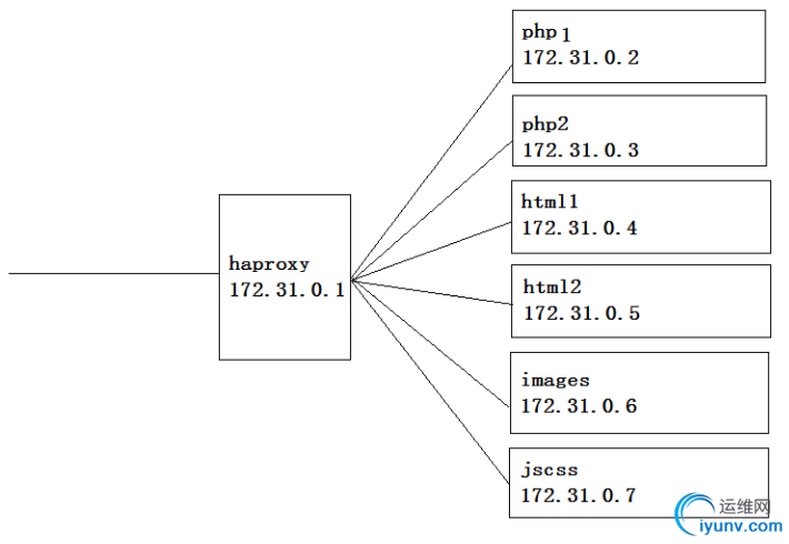

An Example:
acl url_static path_beg /static /images /img /css
acl url_static path_end .gif .png .jpg .css .js
acl host_www hdr_beg(host) -i www
acl host_static hdr_beg(host) -i img. video. download.
use_backend static if host_static or host_www
  配置案例:
global
log 127.0.0.1 local2
pidfile /var/run/haproxy.pid
maxconn 4000
user haproxy
group haproxy
daemon
defaults
mode http
log global
option httplog
option dontlognull
option http-server-close
option forwardfor except 127.0.0.0/8
option redispatch
retries 3
timeout http-request 10s
timeout queue 1m
timeout connect 10s
timeout client 1m
timeout server 1m
timeout http-keep-alive 10s
timeout check 10s
maxconn 3000
frontend webserver
bind *:80
acl php path_end .php
acl html path_end .html
acl jc path_end .js .css
use_backend dynamic if php
use_backend static if html
use_backend images if image
use_backend jscss if jc
default_backend static
backend dynamic
balance roundrobin
server php1 172.31.0.2:80 check inter 2000 rise 5 fall 2 weight 1
server php2 172.31.0.3:80 check inter 2000 rise 5 fall 2 weight 1
server error 127.0.0.1:80 backup weight 1
backend static
balance roundrobin
server html1 172.31.0.4:80 check inter 2000 rise 5 fall 2 weight 1
server html2 172.31.0.5:80 check inter 2000 rise 5 fall 2 weight 1
backend images
balance roundrobin
server image 172.31.0.6:80 check inter 2000 rise 5 fall 2 weight 1
backend jscss
balance roundrobin
server js_css 172.31.0.17:80 check inter 2000 rise 5 fall 2 weight 1
