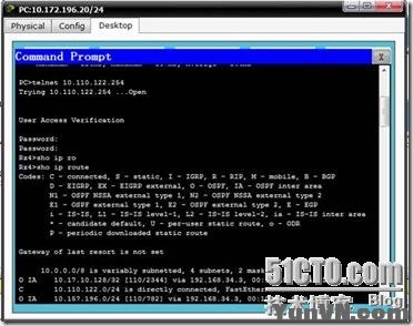

用ping命令测试:
PC>ping DNS.Server.com
Pinging 10.157.196.10 with 32 bytes of data:
Reply from 10.157.196.10: bytes=32 time=125ms TTL=125
Reply from 10.157.196.10: bytes=32 time=110ms TTL=125
Reply from 10.157.196.10: bytes=32 time=78ms TTL=125
Ping statistics for 10.157.196.10:
Packets: Sent = 4, Received = 4, Lost = 0 (0% loss),
Approximate round trip times in milli-seconds:
Minimum = 78ms, Maximum = 125ms, Average = 109ms
PC>
PC>ping Web.cysd.com
Pinging 112.10.17.3 with 32 bytes of data:
Reply from 112.10.17.3: bytes=32 time=110ms TTL=124
Reply from 112.10.17.3: bytes=32 time=143ms TTL=124
Reply from 112.10.17.3: bytes=32 time=141ms TTL=124
Reply from 112.10.17.3: bytes=32 time=172ms TTL=124
Ping statistics for 112.10.17.3:
Minimum = 110ms, Maximum = 172ms, Average = 141ms
PC>

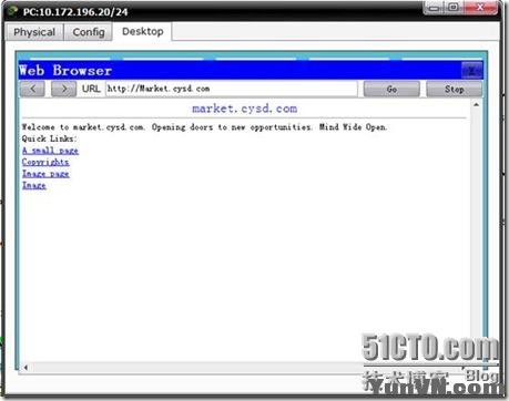

PC>ping Market.cysd.com
Pinging 10.110.122.3 with 32 bytes of data:
Reply from 10.110.122.3: bytes=32 time=156ms TTL=124
Reply from 10.110.122.3: bytes=32 time=140ms TTL=124
Reply from 10.110.122.3: bytes=32 time=128ms TTL=124
Reply from 10.110.122.3: bytes=32 time=141ms TTL=124
Ping statistics for 10.110.122.3:

对路由器进行安全设置:
1、 对路由器进行con和vty配置:
R1:
Rz1>en
Rz1#conf t
Enter configuration commands, one per line. End with CNTL/Z.
Rz1(config)#line console 0
Rz1(config-line)#password cisco
Rz1(config-line)#login
Rz1(config-line)#exit
Rz1(config)#line vty 0 4
Rz1(config)#enable password cisco
Rz1(config)#service password-encryption
Rz1(config)#end
%SYS-5-CONFIG_I: Configured from console by console
Rz1#write
Building configuration...
[OK]
Rz1#
R2:
Rz2>enable
Rz2#conf t
Rz2(config)#line console 0
Rz2(config-line)#password cisco
Rz2(config-line)#login
Rz2(config-line)#exit
Rz2(config)#line vty 0 4
Rz2(config)#enable password cisco
Rz2(config)#service password-encryption
Rz2(config)#end
Rz2#write
[OK]
Rz2#
R3:
Rz3>enable
Rz3#conf t
Rz3(config)#line console 0
Rz3(config-line)#password cisco
Rz3(config-line)#login
Rz3(config-line)#exit
Rz3(config)#line vty 0 4
Rz3(config)#enable password cisco
Rz3(config)#service password-encryption
Rz3(config)#end
Rz3#write
[OK]
Rz3#
R4:
Rz4>enable
Rz4#conf t
Rz4(config)#line console 0
Rz4(config-line)#password cisco
Rz4(config-line)#login
Rz4(config-line)#exit
Rz4(config)#line vty 0 4
Rz4(config)#enable password cisco
Rz4(config)#service password-encryption
Rz4(config)#end
Rz4#write
[OK]
Rz4#
实验完成。
