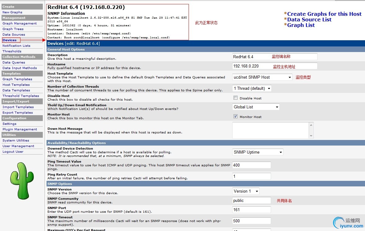

[iyunv@localhost ~]# yum -y install rrdtool rrdtool-devel net-snmp net-snmp-utils
[iyunv@localhost ~]# vim /etc/snmp/snmpd.conf
41   com2sec notConfigUser  192.168.0.218   public                  ##  IP、共同体名
62   access  notConfigGroup "" any noauth  exact  all none none     ##  改为all
85   view all    included  .1            80                         ##  注释去掉
[iyunv@localhost ~]# service snmpd start
正在启动 snmpd:                                           [确定]
[iyunv@localhost ~]# chkconfig --add snmpd
[iyunv@localhost ~]# chkconfig --level 35 snmpd on

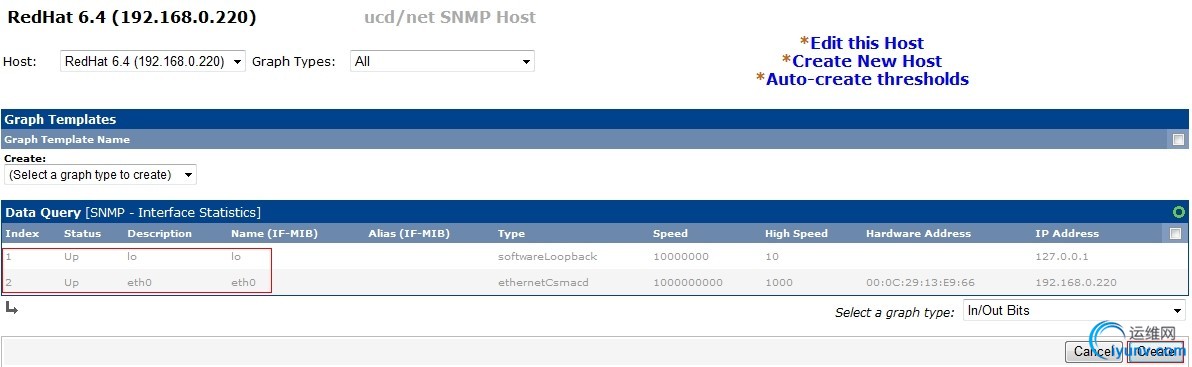

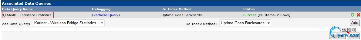

  接下来点击 Create Graphs for this Host  就可以检测到主机的两块网卡 可以选择添加

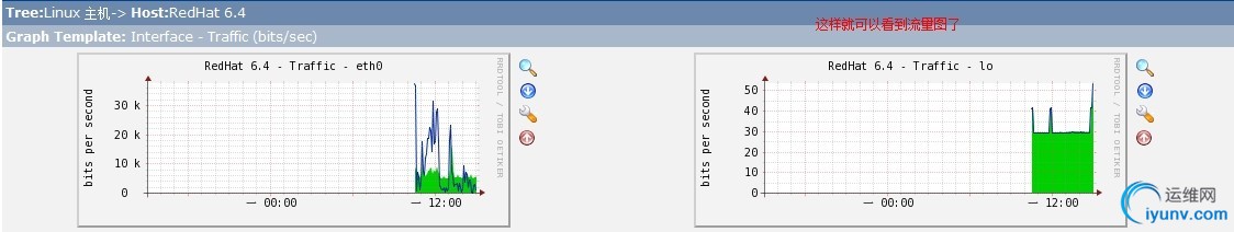

  [iyunv@localhost ~]# crontab -u cactiuser -e
[iyunv@localhost ~]# crontab -u cactiuser -l   ##  这样的话 cacti 就可以出图了
*/2 * * * * /usr/local/php/bin/php /usr/local/apache/htdocs/cacti/poller.php > /dev/null 2>&1

[iyunv@localhost ~]# cat /usr/local/apache/logs/error_log     ##  这是 cacti 出图无数据的情况 php 时区报错
[Wed Feb 12 16:01:41.030899 2014] [:error] [pid 33783:tid 140656573892352] [client 192.168.0.180:63160] PHP Warning:  date(): It is not safe to rely on the system's timezone settings. You are *required* to use the date.timezone settingor the date_default_timezone_set() function. In case you used any of those methods and you are still getting this warning, you most likely misspelled the timezone identifier. We selected the timezone 'UTC' for now, but please set date.timezone to select yourtimezone. in /usr/local/apache/htdocs/cacti/include/global_arrays.php on line 672, referer: http://192.168.0.220/cacti/graph_view.php?action=tree&tree_id=1&leaf_id=7
处理方法:
[iyunv@localhost ~]# vim /usr/local/php/php.ini
919 date.timezone = "Asia/shanghai"      ##  将时区改为上海
[iyunv@localhost ~]# /usr/local/apache/bin/apachectl restart     ##  重启 apache 查看 cacti 是否有数据

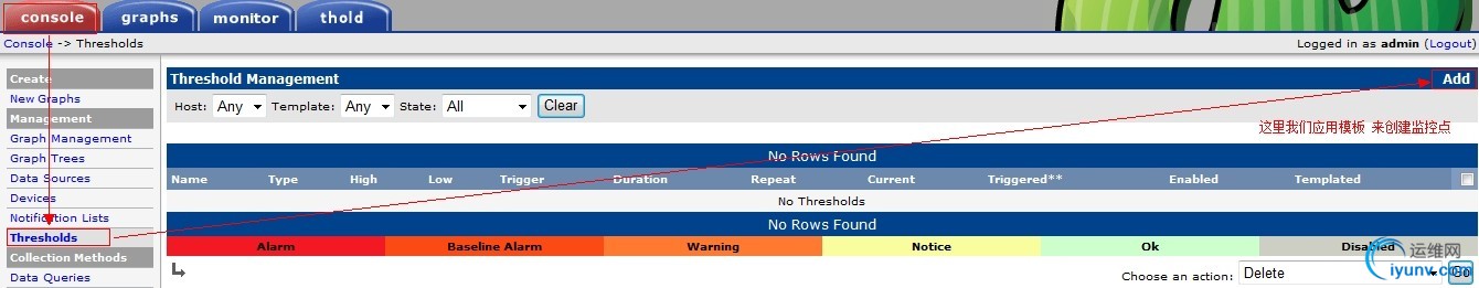

monitor 提供更简略、直观的设备状态图 Settings 、thold 用于设置邮件报警
[iyunv@localhost src]# tar zxf monitor-v1.3-1.tgz
[iyunv@localhost src]# mv monitor ../apache/htdocs/cacti/plugins/
[iyunv@localhost src]# tar zxf settings-v0.71-1.tgz
[iyunv@localhost src]# mv settings ../apache/htdocs/cacti/plugins
[iyunv@localhost src]# tar zxf thold-v0.5.0.tgz
[iyunv@localhost src]# mv thold ../apache/htdocs/cacti/plugins
[iyunv@localhost src]# vim ../apache/htdocs/cacti/include/plugins.php
9  $plugin_hooks = array();            ##  搜索到第九行的字段之后在下一行加入内容,保存退出
10 $plugins[] = 'monitor';
11 $plugins[] = 'settings';
12 $plugins[] = 'thold';
##  接着打开 cacti->console->Plugin Management->在这里可以看到添加的插件名前面有一个蓝色向下的箭头->点击之后在点旁边的绿色向右的箭头就可以显示出你的插件了。

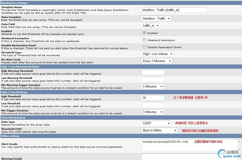

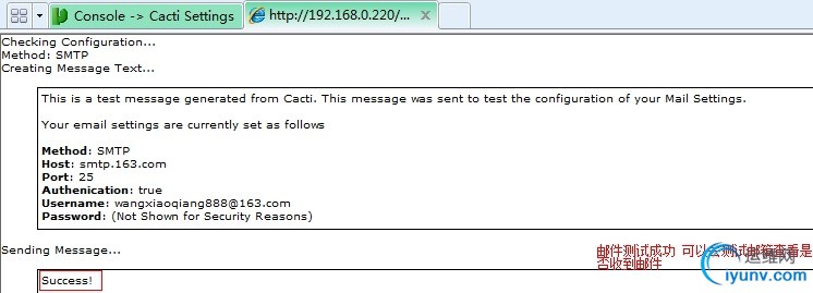

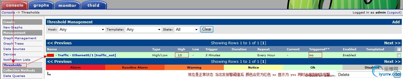

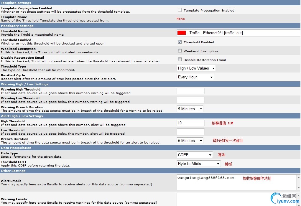

  五、配置插件实现邮件报警
  好的  Cacti 全部完工,有什么不懂的地方给我留言!
