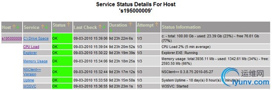

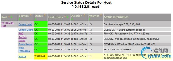

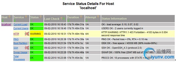

保存nagios.cfg后,用service httpd restart重启nagios服务,如果失败,用/usr/local/nagios/bin/nagios -v /usr/local/nagios/etc/nagios.cfg验证,会提示出问题所在,关于问题解决在后面再将,这里只是服务器自身监控,应该不会有问题。
IEhttp://IP/nagios,输入nagiosadmin和密码(1和图2)

重启nagiosie浏览(3)

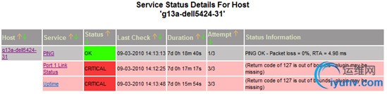

Switch就完成,红色见问题3(4)

服务器
  [iyunv@localhost ~]# vi /usr/local/nagios/etc/nagios.cfg
# Definitions for monitoring a Windows machine
cfg_file=/usr/local/nagios/etc/objects/windows.cfg
[iyunv@localhost ~]# vi /usr/local/nagios/etc/objects/windows.cfg
windows.cfg没有什么可改的,只是把hostnameip改了就行了(5)

3、是因为nagios服务器中没有check_snmp命令,有安装nagios之前没有安装net-snmpnet-snmp-utils组件。网上有人提示安装组件后在重新安装nagios-plugins-1.4.15,我没有成功。(6)
  [iyunv@localhost nagios]# libexec/check_snmp -h
-bash: libexec/check_snmp: No such file or directory
