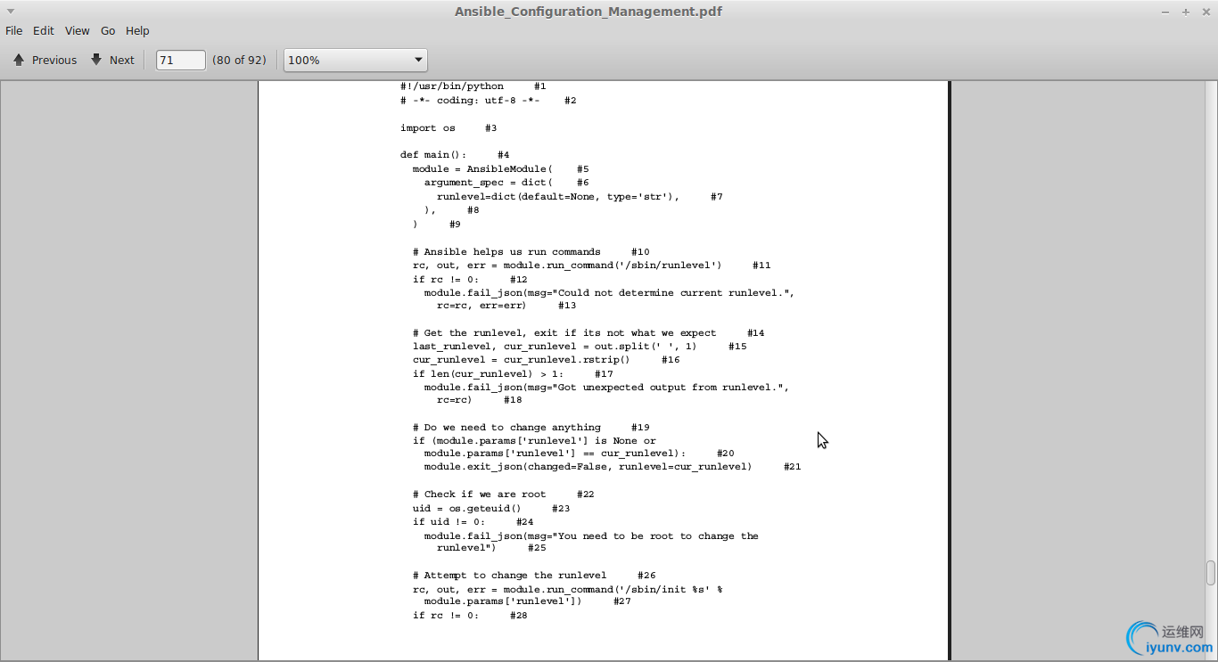

  The following code actually manages the init level of the system. Comments have
been included in the following code to explain what it does.
def main():
module = AnsibleModule(
argument_spec = dict(
<img src=&quot;http://img.blog.csdn.net/20140715221253046?1/1.jpg"2/text/aHR0cDovL2Jsb2cuY3Nkbi5uZXQvc21hbGxmaXNoMTk4Mw==/font/5a6L5L2T/fontsize/400/fill/I0JBQkFCMA==/dissolve/70/gravity/SouthEast&quot; alt=&quot;&quot; />
下面这段代码现实了模块如何管理init级别,注释已经包含在代码中了:
  上面这段python代码很简单,我就不解释了,有疑问的同学可以留言。
