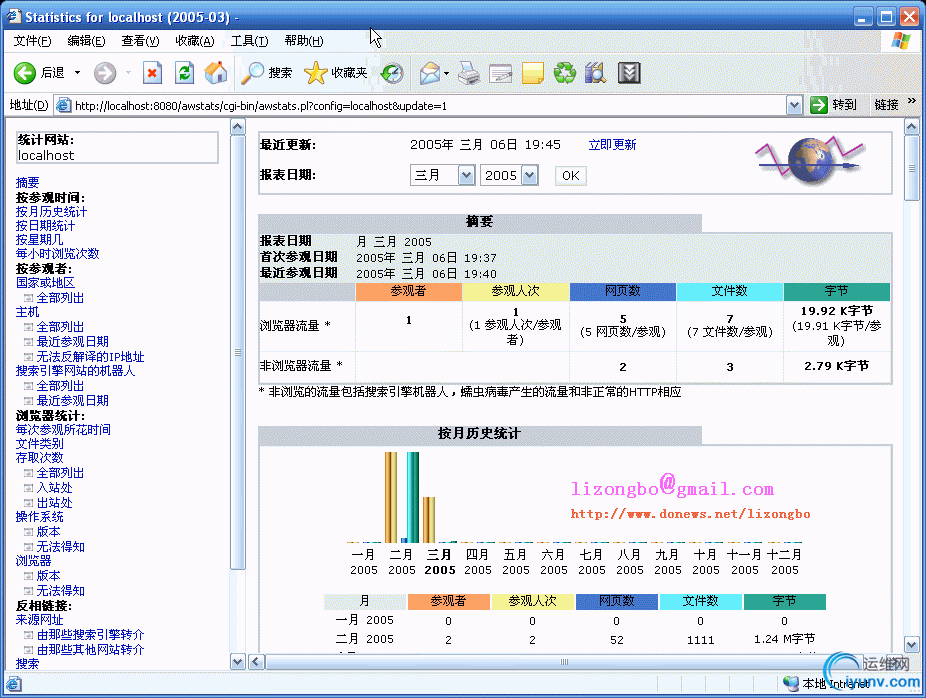

启动Tomcat,通过
http://localhost:8080/awstats/cgi-bin/awstats.pl?config=localhost&update=1
就可以生成日志分析结果了。

  Type http://www.mydomain.com/awstats/cgi-bin/awstats.pl?config=www.mydomain.com. That was all.
