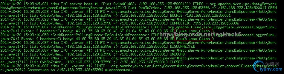

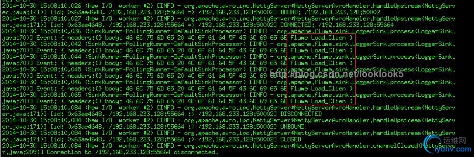

  下面是测试的开发例子
import java.nio.charset.Charset;
import org.apache.flume.Event;
import org.apache.flume.EventDeliveryException;
import org.apache.flume.api.RpcClient;
import org.apache.flume.api.RpcClientFactory;
import org.apache.flume.event.EventBuilder;
import java.util.Properties;
public class Load_Client {
public static void main(String[] args) {
MyRpcClientFacade3 client = new MyRpcClientFacade3();
// Initialize client with the remote Flume agent's host and port
client.init();
// Send 10 events to the remote Flume agent. That agent should be
// configured to listen with an AvroSource.
String sampleData = &quot;Flume Load_Client&quot;;
for (int i = 0; i < 10; i++) {
client.sendDataToFlume(sampleData);
client.cleanUp();
class MyRpcClientFacade3{
private RpcClient client;
private String hostname;
private int port;
public void init() {
Properties props = new Properties();
props.put(&quot;client.type&quot;, &quot;default_loadbalance&quot;);
// List of hosts (space-separated list of user-chosen host aliases)
props.put(&quot;hosts&quot;, &quot;h1 h2 h3&quot;);
// host/port pair for each host alias
String host1 = &quot;192.168.233.128:50000&quot;;
String host2 = &quot;192.168.233.128:50001&quot;;
String host3 = &quot;192.168.233.128:50002&quot;;
props.put(&quot;hosts.h1&quot;, host1);
props.put(&quot;hosts.h2&quot;, host2);
props.put(&quot;hosts.h3&quot;, host3);
props.put(&quot;host-selector&quot;, &quot;random&quot;); // For random host selection
// props.put(&quot;host-selector&quot;, &quot;round_robin&quot;); // For round-robin host

  下面是Host1,收到了2条数据
  下面是Host2,收到了2条数据
  下面是Host3,收到了6条数据。
  可以看到我们开发例子中,host-selector选择的是随机,因此程序也是随机发送数据。下面我们测试轮询round_robin选项。
