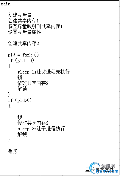

六、实例
    互斥量属性使用
    1、程序框架
    2、源代码

  •     int shm_id, shm_id1;
  •     char *buf;
  •     pid_t pid;
  •     pthread_mutex_t *mutex;
  •     pthread_mutexattr_t mutexattr;
  •     //打开共享内存
  •     shm_id1 = shm_open(shm1, O_RDWR|O_CREAT, 0644);
  •     //调整共享内存大小
  •     ftruncate(shm_id1, 100);
  •     //映射共享内存,MAP_SHARED属性表明,对共享内存的任何修改都会影响其他进程
  •     mutex =(pthread_mutex_t *)mmap(NULL, 100, PROT_READ|PROT_WRITE, MAP_SHARED, shm_id1, 0);
  •     pthread_mutexattr_init(&mutexattr);
  • #ifdef _POSIX_THREAD_PROCESS_SHARED
  •     pthread_mutexattr_setpshared(&mutexattr, PTHREAD_PROCESS_SHARED);
  • #endif
  •     pthread_mutex_init(mutex, &mutexattr);
  •     //打开共享内存
  •     shm_id = shm_open(shm, O_RDWR|O_CREAT, 0644);
  •     //调整共享内存大小
  •     ftruncate(shm_id, 100);
  •     buf =(char *)mmap(NULL, 100, PROT_READ|PROT_WRITE, MAP_SHARED, shm_id, 0);
  •     pid = fork();
  •     if(pid==0)
  •         //休眠1s,让父进程先运行
  •         sleep(1);
  •         printf("I'm child proccess\n");
  •         pthread_mutex_lock(mutex);
  •         //将共享内存内存修改为hello
  •         memcpy(buf, "hello", 6);
  •         printf("child buf is : %s\n", buf);
  •         pthread_mutex_unlock(mutex);
  •     else if(pid>0)
  •         printf("I'm parent proccess\n");
  •         //修改共享内存到内容,改为world
  •         memcpy(buf, "world", 6);
  •         sleep(3);
  •         printf("parent buf is : %s\n", buf);
  •     pthread_mutexattr_destroy(&mutexattr);
  •     pthread_mutex_destroy(mutex);
  •     //解除映射
  •     munmap(buf, 100);
  •     //消除共享内存
  •     shm_unlink(shm);
  •     //解除映射
  •     munmap(mutex, 100);
  •     //消除共享内存
  •     shm_unlink(shm1);
