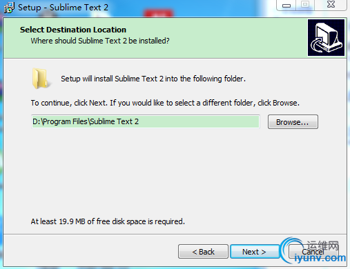

  First search and download sublime text, then install the software.
  Just do as instruction, you can easily finish the installation.

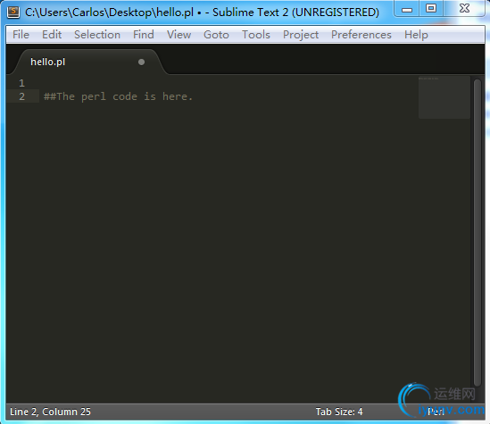

  The installation is finished. Now you can write your perl codes by sublime. Note that the suffix of the file must be ".pl" or ".pm". However, you can not run your codes. To implement this function, you should move one more step.

  Open Sublime, create a file saved as "hello.pl", type your code as follows:
