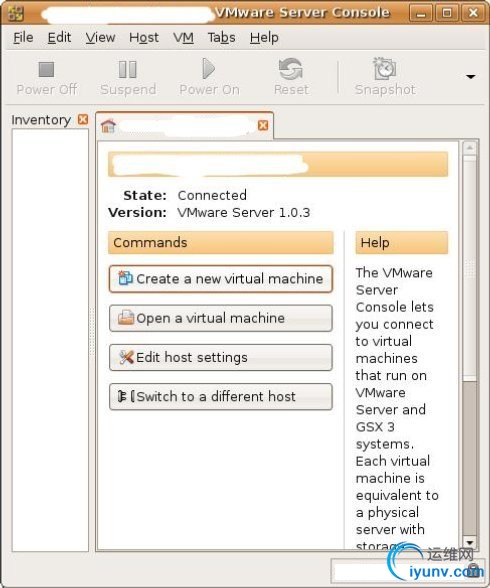

How do I manage my VMWARE server remotely?
  You can now connect fromlocal computerusing vmware-server-console program to:
  • Configure VM Guest oses
  • Configure VM hardware
  • Install new VPS / VM guest oses such as FreeBSD, Windows or any other operating systems etc
  $ vmware-server-console &
You need to enter host name ip:port, username and password to access vmware server.
