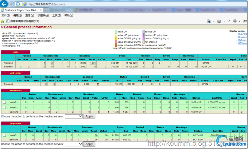

listen stats
      mode http
      bind 0.0.0.0:91
      stats enable
      stats uri /admin
      stats realm "Admin console"
      stats auth admin:123456
      stats hide-version
      stats refresh 10s
      stats admin if TRUE

      option httpchk GET /test.html HTTP/1.0\r\nHost:192.168.0.26
      server node01 192.168.0.24:8080 weight 3 check inter 2000 rise 2 fall 1
      server node02 192.168.0.25:8080 weight 3 check inter 2000 rise 2 fall 1
backend phpserver
      balance roundrobin
      option httpchk GET /test.php
