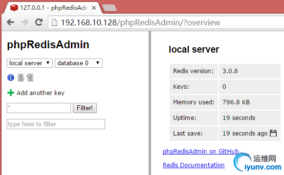

使用phpRedisAdmin管理Redis
①下载安装相关程序
10
11
12
13
14
15
# yum -y install php-mbstring
# git clone https://github.com/ErikDubbelboer/phpRedisAdmin.git
正克隆到 'phpRedisAdmin'...
remote: Counting objects: 560, done.
remote: Total 560 (delta 0), reused 0 (delta 0), pack-reused 560
接收对象中: 100% (560/560), 165.53 KiB | 97.00 KiB/s, done.
处理 delta 中: 100% (332/332), done.
# cd phpRedisAdmin/
# git clone https://github.com/nrk/predis.git vendor
正克隆到 'vendor'...
remote: Counting objects: 19472, done.
remote: Total 19472 (delta 0), reused 0 (delta 0), pack-reused 19472
接收对象中: 100% (19472/19472), 4.98 MiB | 669.00 KiB/s, done.
处理 delta 中: 100% (11908/11908), done.
# mv phpRedisAdmin /var/www/html/
②使用用phpRedisAdmin
浏览器输入http://localhost/phpRedisAdmin进入(默认无需帐号密码,需自行设置)
问题:
phpRedisAdmin无法打开,提示HTTP 500错误,且httpd日志显示如下:
PHP Fatal error:  Call to undefined function mb_internal_encoding() in /var/www/html/phpRedisAdmin/includes/common.inc.php on line 59
解决:
缺少php-mbstring扩展,yum -y install php-mbstring
