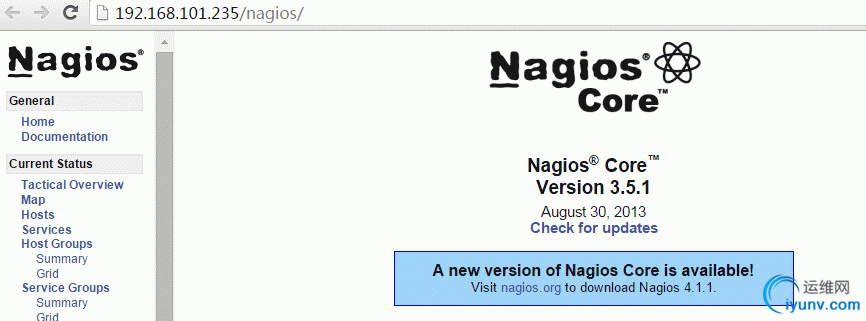

浏览器访问: http://192.168.101.235/nagios
