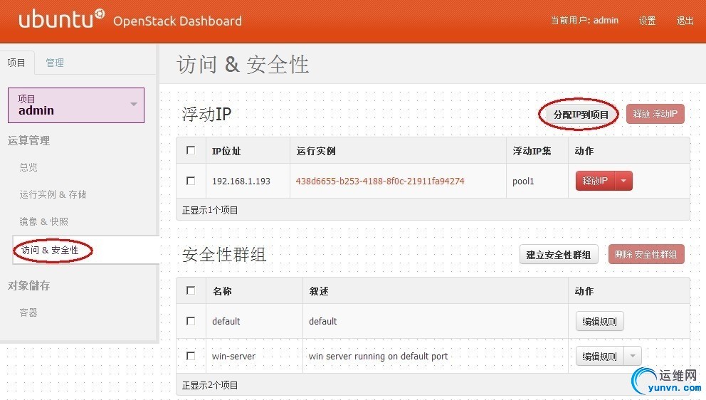

3、安全组(防火墙规则)
nova secgroup-add-rule default tcp 1 65535 0.0.0.0/0
nova secgroup-add-rule default udp 1 65535 0.0.0.0/0
nova secgroup-add-rule default icmp -1 -1 0.0.0.0/0
Create the win-server security group to allow ping (icmp), ssh (tcp/22), and http (tcp/80) from everywhere (0.0.0.0/0):
nova secgroup-create win-server "win server running on default port"
nova secgroup-add-rule win-server icmp -1 -1 0.0.0.0/0
nova secgroup-add-rule win-server tcp 22 22 0.0.0.0/0
nova secgroup-add-rule win-server tcp 3389 3389 0.0.0.0/0
nova secgroup-add-rule win-server tcp 80 80 0.0.0.0/0
nova secgroup-add-rule win-server tcp 20 20 0.0.0.0/0
nova secgroup-add-rule win-server tcp 21 21 0.0.0.0/0
4、创建浮动IP
nova-manage floating create --pool=pool1 --ip_range=10.10.128.192/26

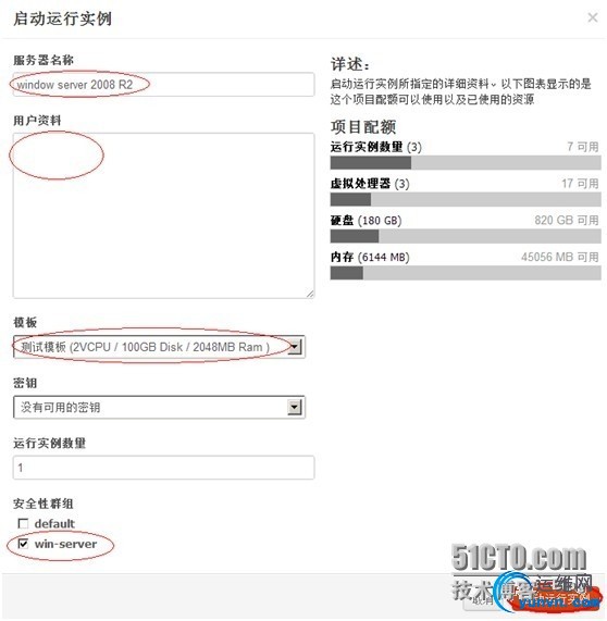

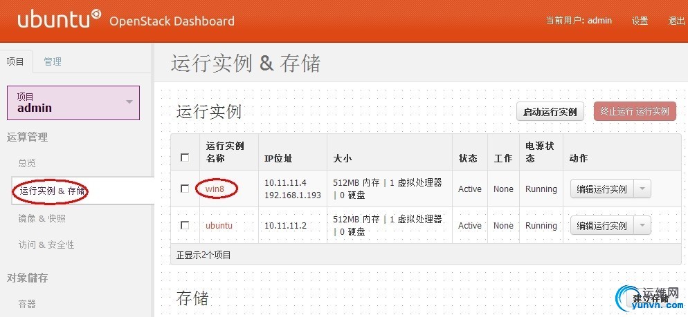

5、使用镜像创建实例(虚拟机)
6、绑定浮动IP
8、VNC控制台
