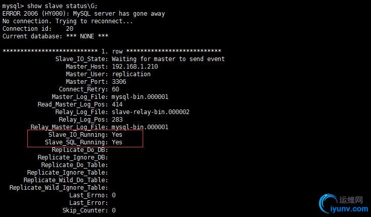

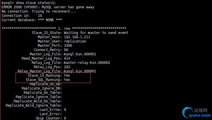

step6:分别在master和slave上查看slave状态,验证是否成功配置主主复制模式
1、master
2、slave
slave状态同步过程可能需要重启MySQL服务
[iyunv@master ~]# service mysqld restart
[iyunv@slave ~]# service mysqld restart

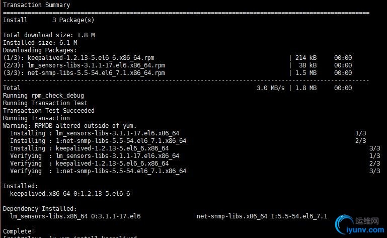

方法一:使用yum安装keepalived,需要安装epel-release源
[iyunv@master ~]# rpm -ivh http://mirrors.opencas.cn/epel/6/i386/epel-release-6-8.noarch.rpm
[iyunv@slave ~]# rpm -ivh http://mirrors.opencas.cn/epel/6/i386/epel-release-6-8.noarch.rpm
[iyunv@slave ~]# yum -y install keepalived
查看keepalived相关目录
[iyunv@slave ~]# ls /usr/sbin/keepalived
[iyunv@slave ~]# ls /etc/init.d/keepalived
[iyunv@slave ~]# ls /etc/keepalived/keepalived.conf

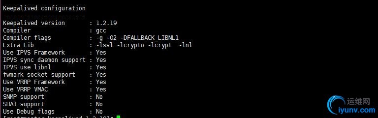

方法二:从keepalived官方网站http://www.keepalived.org下载源代码包编译安装
1、下载keepalived最新版
[iyunv@master ~]# wget http://www.keepalived.org/software/keepalived-1.2.19.tar.gz
[iyunv@slave ~]# wget http://www.keepalived.org/software/keepalived-1.2.19.tar.gz
2、安装keepalived依赖软件包
[iyunv@master ~]# yum install  pcre-devel openssl-devel popt-devel libnl-devel
3、解压并安装keepalived
[iyunv@master ~]# tar zxf keepalived-1.2.19.tar.gz
[iyunv@master ~]# cd keepalived-1.2.19
[iyunv@master keepalived-1.2.19]# ./configure --prefix=/usr/local/keepalived
--sysconf=/etc --with-kernel-dir=/usr/src/kernels/2.6.32-431.el6.x86_64
[iyunv@master keepalived-1.2.19]# make
[iyunv@master keepalived-1.2.19]# make install

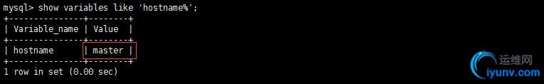

step4:测试keepalived高可用功能
1、远程主机登录通过VIP192.168.1.208登录MySQL,查看MySQL连接状态
mysql> show variables like 'hostname%';
| Variable_name | Value  |
| hostname      | master |
1 row in set (0.00 sec)
从上面查看的结果看样看出在正常情况下连接的是master

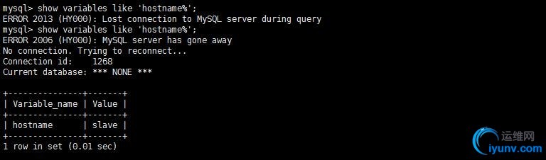

2、故障测试,停止master的MySQL服务,再次查看是否转移至slave服务器上
[iyunv@master ~]# service mysqld stop
Shutting down MySQL.... SUCCESS!
10
11
12
13
14
ERROR 2013 (HY000): Lost connection to MySQL server during query
ERROR 2006 (HY000): MySQL server has gone away
No connection. Trying to reconnect...
Connection id:    1268
Current database: *** NONE ***
| hostname      | slave |
1 row in set (0.01 sec)
由测试结果可以看出,keepalived成功转移MySQL服务
