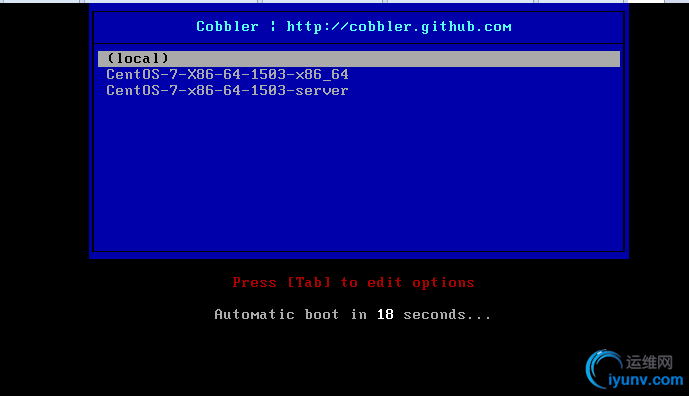

[iyunv@localhost cobbler]# cobbler import --help   #使用import命令将光盘制作为distro
Usage: cobbler [options]
Options:
  -h, --help            show this help message and exit
  --arch=ARCH           OS architecture being imported
  --breed=BREED         the breed being imported
  --os-version=OS_VERSION
                        the version being imported
  --path=PATH           local path or rsync location
  --name=NAME           name, ex 'RHEL-5'
  --available-as=AVAILABLE_AS
                        tree is here, don't mirror
  --kickstart=KICKSTART_FILE
                        assign this kickstart file
  --rsync-flags=RSYNC_FLAGS
                        pass additional flags to rsync
[iyunv@localhost cobbler]# cobbler import --name="CentOS-7-X86-64-1503" --path=/media/cdrom
task started: 2016-02-23_142932_import
task started (id=Media import, time=Tue Feb 23 14:29:32 2016)
[iyunv@localhost ~]# ls /var/www/cobbler/ks_mirror/   #在该目录下生成我们指定的文件
CentOS-7-X86-64-1503  config
[iyunv@localhost cobbler]# cobbler distro list   #生成的distro
   CentOS-7-X86-64-1503-x86_64
[iyunv@localhost cobbler]# cobbler profile list  #生成的profile文件
注:cobbler会根据profile自动生成kickstart文件
测试结果:

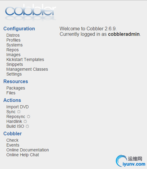

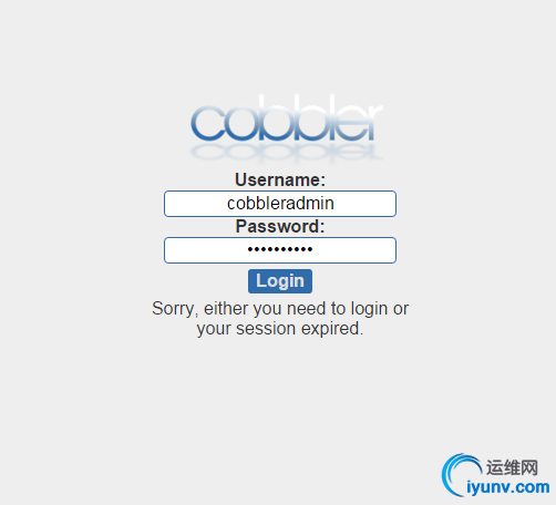

四、cobbler_web
10
11
[iyunv@localhost ~]# yum install -y cobbler-web   #安装cobbler-web
[iyunv@localhost ~]# vim /etc/cobbler/modules.conf
[authentication]
module = authn_configfile    #基于configfile认证
[iyunv@localhost ~]# htdigest -c /etc/cobbler/users.digest Cobbler cobbleradmin  #生成管理员用户与密码
Adding password for cobbleradmin in realm Cobbler.
New password:
Re-type new password:
[iyunv@localhost ~]# systemctl restart cobblerd
测试结果:
