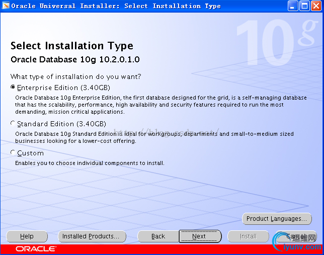

5、Oracle用户安装Oracle软件
$ ./runInstaller
Your platform requires the root user to perform certain pre-installation
OS preparation.  The root user should run the shell script 'rootpre.sh' be
fore
you proceed with Oracle installation.  rootpre.sh can be found at the top
level
of the CD or the stage area.
Answer 'y' if root has run 'rootpre.sh' so you can proceed with Oracle
installation.
Answer 'n' to abort installation and then ask root to run 'rootpre.sh'.
Has 'rootpre.sh' been run by root? [y/n] (n)
y
Starting Oracle Universal Installer...
No pre-requisite checks found in oraparam.ini, no system pre-requisite checks will be executed.

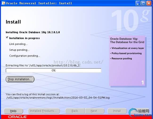

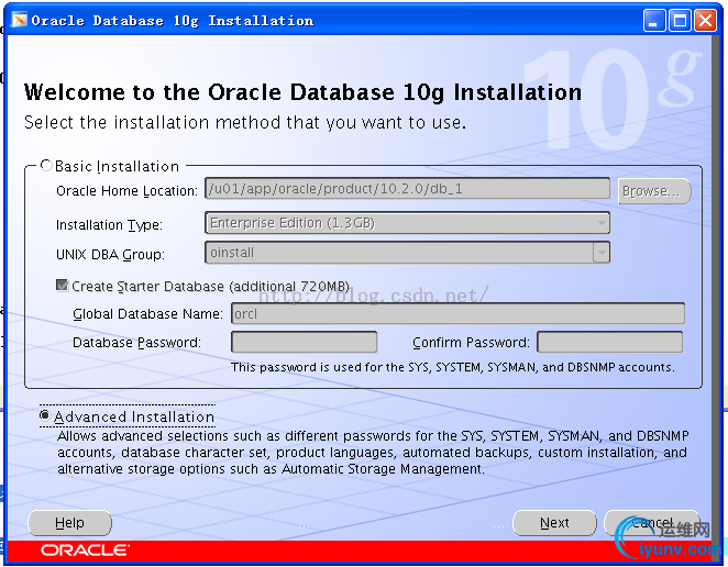

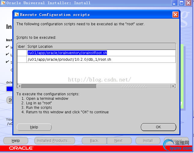

Preparing to launch Oracle Universal Installer from /tmp/OraInstall2016-03-02_04-50-31PM. Please wait ...$ Mar 2, 2016 4:50:50 PM java.util.prefs.FileSystemPreferences$2 run
INFO: Created user preferences directory.
Mar 2, 2016 4:50:54 PM java.util.prefs.FileSystemPreferences$3 run
INFO: Created system preferences directory in java.home.
------  可以看到警告信息,Oracle 10gR2默认不支持aix 6.1 !
----  Oracle安装成功 !
