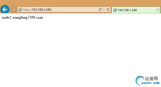

       我们模拟node1坏掉,可以将corosync关掉,在node2上查看集群工作状态
[iyunv@node2 ~]# pcs status
Cluster name:
Last updated: Mon Apr 21 00:31:59 2014
Last change: Mon Apr 21 00:28:32 2014 via cibadmin on node1.wangfeng7399.com
Stack: classic openais (with plugin)
Current DC: node2.wangfeng7399.com - partition WITHOUT quorum
Version: 1.1.10-14.el6_5.2-368c726
2 Nodes configured, 2 expected votes
1 Resources configured
Online: [ node2.wangfeng7399.com ]
OFFLINE: [ node1.wangfeng7399.com ]
Full list of resources:
WebIP  (ocf::heartbeat:IPaddr2):   Stopped
   上面的信息显示node1.wangfeng7399.com已经离线,但资源WebIP却没能在node2.wangfeng7399.com上启动。这是因为此时的集群状态为"WITHOUT quorum",即已经失去了quorum,此时集群服务本身已经不满足正常运行的条件,这对于只有两节点的集群来讲是不合理的。因此,我们可以通过如下的命令来修改忽略quorum不能满足的集群状态检查:
[iyunv@node2 ~]# pcs property set no-quorum-policy="ignore"
片刻之后,集群就会在目前仍在运行中的节点node2上启动此资源了,如下所示:
[iyunv@node2 ~]# ip add
1: lo:  mtu 16436 qdisc noqueue state UNKNOWN
    link/loopback 00:00:00:00:00:00 brd 00:00:00:00:00:00
    inet 127.0.0.1/8 scope host lo
    inet6 ::1/128 scope host
       valid_lft forever preferred_lft forever
2: eth0:
mtu 1500 qdisc pfifo_fast state UP qlen 1000
    link/ether 00:0c:29:ab:d1:9c brd ff:ff:ff:ff:ff:ff
    inet 192.168.1.201/24 brd 192.168.1.255 scope global eth0
    inet 192.168.1.240/24 brd 192.168.1.255 scope global secondary eth0
    inet6 fe80::20c:29ff:feab:d19c/64 scope link

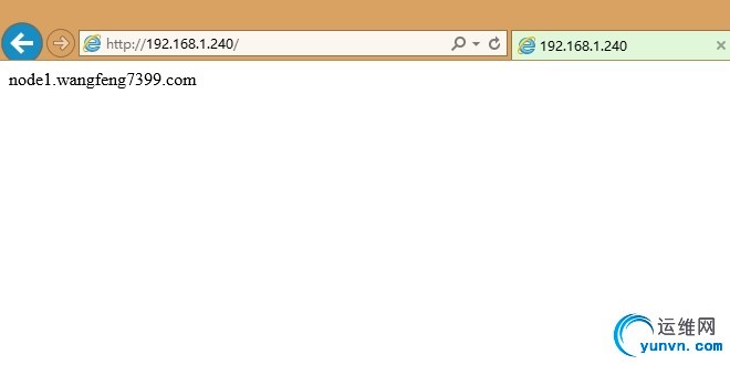

7、结合上面已经配置好的IP地址资源,将此集群配置成为一个active/passive模型的web(httpd)服务集群
   为了将此集群启用为web(httpd)服务器集群,我们得先在各节点上安装httpd,并配置其能在本地各自提供一个测试页面。
[iyunv@node1 corosync]# echo "node1.wangfeng7399.com" > /var/www/html/index.html
[iyunv@node2 ~]# echo "node2.wangfeng7399.com" > /var/www/html/index.html
然后关闭httpd,并确保开机不能自启动
[iyunv@node2 ~]# chkconfig httpd off
[iyunv@node1 corosync]# chkconfig httpd off

   8.测试
将node1停掉
