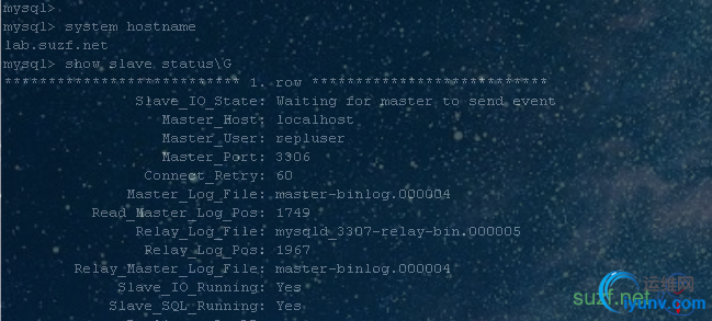

    -> MASTER_AUTO_POSITION = 1;
Query OK, 0 rows affected, 2 warnings (0.04 sec)
mysql> start slave;
Query OK, 0 rows affected (0.19 sec)
验证

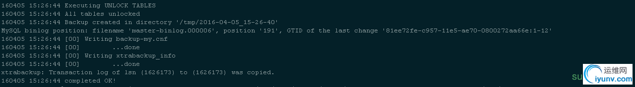

我们将使用下面命令完整数据库备份:
$innobackupex --defaults-file=/opt/data/backup/mysql/3306.cnf --user=root  --socket=/usr/local/mysql/data/run/mysqld_3306.sock  /tmp
这里要注意的重要的文件是在xtrabackup_binlog_info
$ cat /tmp/2016-04-05_15-26-40/xtrabackup_binlog_info
master-binlog.000006  191 81ee72fe-c957-11e5-ae70-0800272aa66e:1-12

启动 slave 查看状态
10
mysql> start slave;
Query OK, 0 rows affected (0.01 sec)
mysql> show slave status\G
             Slave_IO_Running: Yes
            Slave_SQL_Running: Yes
      Slave_SQL_Running_State: Slave has read all relay log; waiting for the slave I/O thread to update it
           Retrieved_Gtid_Set: 81ee72fe-c957-11e5-ae70-0800272aa66e:13
            Executed_Gtid_Set: 81ee72fe-c957-11e5-ae70-0800272aa66e:1-13
                Auto_Position: 1
