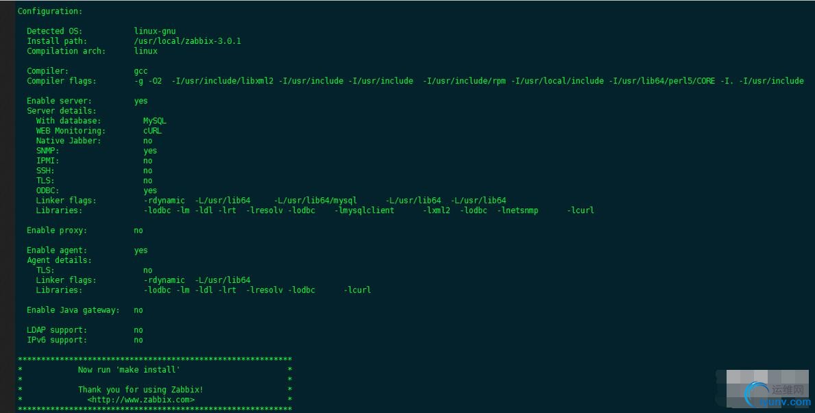

        # ./configure --prefix=/usr/local/zabbix-3.0.1 --enable-server --enable-agent --with-mysql                             --with-net-snmp --with-libcurl --with-libxml2 --with-unixodbc
QQ截图20160407084940.jpg         #make install
