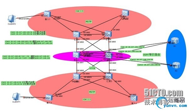

网络拓扑如图所示:
网络地址规划:vlan 2 10.147.140.0/26
              vlan 3 10.147.140.64/26  用于行政楼段;
              vlan 4 10.147.140.128/26
              vlan 5 10.147.140.192/26 用于中控楼段;
              vlan 10 10.147.141.0/30
              vlan 11 10.147.141.4/30
              vlan 12 10.147.141.8/30
              vlan 13 10.147.141.12/30 用于核心交换机到路由器互联网段。
网络协议使用:接入层到汇聚层使用MSTP,各设置两个实例,分别以其中某台汇聚交换机实例为区域                 根;
              汇聚层到核心层使用VRRP,使用4个虚拟组,分别以某台核心交换机为master,另一台为               backup;
              核心层至广域网使用OSPF,设置成等价路径。
模拟情境:
接入层设备配置情况:

vrrp vrid 4 virtual-ip 10.147.141.190
interface Vlanif5
ip address 10.147.141.253 255.255.255.192
vrrp vrid 5 virtual-ip 10.147.141.254
vrrp vrid 5 priority 110
vrrp vrid 5 preempt-mode timer delay 30
interface Vlanif11
ip address 10.147.140.133 255.255.255.252
interface Vlanif12
ip address 10.147.140.137 255.255.255.252
interface MEth0/0/1
interface GigabitEthernet0/0/1
interface GigabitEthernet0/0/2
interface GigabitEthernet0/0/3
port link-type trunk
port trunk allow-pass vlan 2 to 5
interface GigabitEthernet0/0/4
interface GigabitEthernet0/0/5
port link-type access
port default vlan 11
interface GigabitEthernet0/0/6
port default vlan 12
interface GigabitEthernet0/0/23
eth-trunk 1
interface GigabitEthernet0/0/24
eth-trunk 1
interface NULL0
interface LoopBack0
ip address 3.3.3.3 255.255.255.255
ospf 1 router-id 3.3.3.3
area 0.0.0.0
  network 10.147.140.128 0.0.0.3
  network 10.147.140.140 0.0.0.3
  network 3.3.3.3 0.0.0.0
user-interface con 0
user-interface vty 0 4
port-group quit
return
路由器配置:
路由器R1:
sysname R1
undo info-center enable
aaa
authentication-scheme default
authorization-scheme default
accounting-scheme default
domain default
domain default_admin
local-user admin password cipher OOCM4m($F4ajUn1vMEIBNUw#
local-user admin service-type http
firewall zone Local
priority 16
interface Ethernet0/0/0
interface Ethernet0/0/1
interface Serial0/0/0
link-protocol ppp
interface Serial0/0/1
link-protocol ppp
interface Serial0/0/2
link-protocol ppp
interface Serial0/0/3
link-protocol ppp
interface GigabitEthernet0/0/0
ip address 10.147.140.130 255.255.255.252
ip address 10.147.140.134 255.255.255.252
wlan
interface NULL0
interface LoopBack0
ip address 1.1.1.1 255.255.255.255
ospf 1 router-id 1.1.1.1
area 0.0.0.0
  network 1.1.1.1 0.0.0.0
  network 10.147.140.132 0.0.0.3
user-interface vty 16 20
return
路由器R2:
sysname R2
aaa
domain default
firewall zone Local
priority 16
link-protocol ppp
link-protocol ppp
link-protocol ppp
link-protocol ppp
ip address 10.147.140.142 255.255.255.252
ip address 10.147.140.138 255.255.255.252
wlan
interface NULL0
interface LoopBack0
ip address 2.2.2.2 255.255.255.255
ospf 1 router-id 2.2.2.2
area 0.0.0.0
  network 2.2.2.2 0.0.0.0
  network 10.147.140.136 0.0.0.3
return
