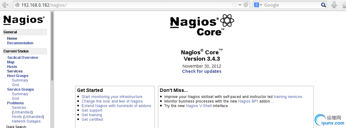

  打开浏览器输入192.168.0.182/nagios,出现报错,于是猜测可能是Selinux和Iptables的问题,关闭:
写道
[iyunv@nagios bin]# setenforce 0
[iyunv@nagios bin]# getenforce
Permissive
[iyunv@nagios bin]# service iptables stop
iptables: Flushing firewall rules: [ OK ]
iptables: Setting chains to policy ACCEPT: filter [ OK ]
iptables: Unloading modules: [ OK ]
  再打开浏览器,就可以访问Nagios了:
