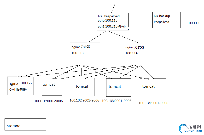

LVS
IP:
Eth0:192.168.100.115
Eth1:192.168.100.215
Vi /etc/init.d./lvs
#!/bin/sh
# lvs     Start lvs
# chkconfig: 2345 08 92
# description:  Starts, stops and saves lvs
SNS_VIP=192.168.100.215
SNS_RIP1=192.168.100.114
SNS_RIP2=192.168.100.113

LVS-realserver
Ip 192.168.100.113
Ip 192.168.100.114
Vi  /etc/init.d/rsup
#!/bin/bash
VIP=192.168.100.215
ifconfig lo:0 $VIP broadcast $VIP netmask255.255.255.255 up
#route add –host $VIP dev lo:0
echo "1">/proc/sys/net/ipv4/conf/lo/arp_ignore
echo "2">/proc/sys/net/ipv4/conf/lo/arp_announce
echo "1">/proc/sys/net/ipv4/conf/all/arp_ignore
echo "2">/proc/sys/net/ipv4/conf/all/arp_announce
#sysctl –p
Nginx
Ip 192.168.100.122(nfs)
Ip 192.168.100.113
Ip 192.168.100.114

  gzip_http_version 1.0;
  gzip_comp_level 2;
  gzip_types       text/plain application/x-javascripttext/css application/xml;
  gzip_vary on;
  server
    listen      80;
    server_name localhost;
    index index.php index.htm;
    root /usr/wodm/;
    location /status
        stub_status on;
    location ~.*.(gif|jpg|jpeg|png|bmp|swf|html|mp3|wma|wmv)$
      expires      30d;
       log_format  access '$remote_addr - $remote_user [$time_local] "$request" '
         '$status $body_bytes_sent"$http_referer" '      '"$http_user_agent" $http_x_forwarded_for';
       access_log  /usr/local/nginx/logs/access.log access;
标准字符集
vi/etc/sysconfig/i18n
LANG="zh_CN.UTF-8"SYSFONT="latarcyrheb-sun16"SUPPORTED="zh_CN.UTF-8:zh_CN:zh"
LANG="zh_CN.GB18030"
SUPPORTED="zh_CN.GB18030:zh_CN:zh:en_US.UTF-8:en_US:en"
打开文件数
vi /etc/security/limits.conf
* soft nofile 65535
* hard nofile 65535
vi /etc/pam.d/login
session required /lib/security/pam_limits.so
nginx  日志按天分割
vi  nginx_log.sh
#!/bin/bash
logs_path="/usr/local/nginx/logs/"
pid_path="/usr/local/nginx/nginx.pid"
mv ${logs_path}access.log ${logs_path}access_$(date -d"yesterday" +"%Y%m%d").log
kill -USR1 `cat ${pid_path}`
chmod 755 nginx_log.sh
crontab –e
0 0 * * *  bash/usr/local/nginx/nginx_log.sh
Tomcat  memcache
tar xf libevent-1.4.11-stable.tar.gz
cd libevent-1.4.11-stable
./configure
make
make install
cd ../
tar xf memcached-1.4.5.tar.gz
cd memcached-1.4.5
./configure
make
make install
/usr/local/bin/memcached -d -m 10 -u root -l 192.168.1.113 -p11211 -c 1024 -P /tmp/memcached.pid
