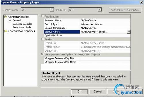

To build your service project
  • In Solution Explorer, right-click your project and select Properties from the shortcut menu. The project's Property Pages dialog box appears.
  • In the left pane, select the General tab in the Common Properties folder.
  • From the Startup object list, choose MyNewService. Click OK.
  • Press Ctrl+Shift+B to build the project.

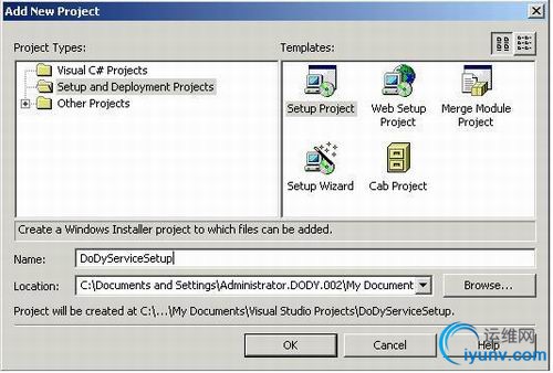

To create a setup project for your service
  • On the File menu, point to Add Project, and then choose New Project.
  • In the Project Types pane, select the Setup and Deployment Projects folder.
  • In the Templates pane, select Setup Project. Name the project MyServiceSetup.
  A setup project is added to the solution. Next you will add the output from the Windows service project, MyNewService.exe, to the setup.

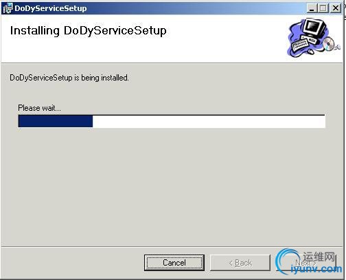

To install the Windows Service
  Browse to the directory where the setup project was saved, and run the .msi file to install MyNewService.exe.

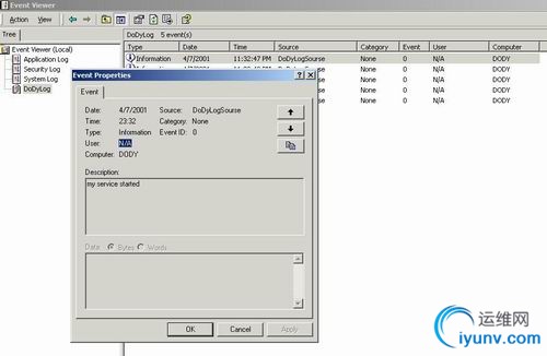

To verify the event log output of your service
  • Open Server Explorer and access the Event Logs node. For more information, see Working with Event Logs in Server Explorer.  Note:The Servers node of Server Explorer is not available in the Standard Edition of Visual Basic and Visual C# .NET.
