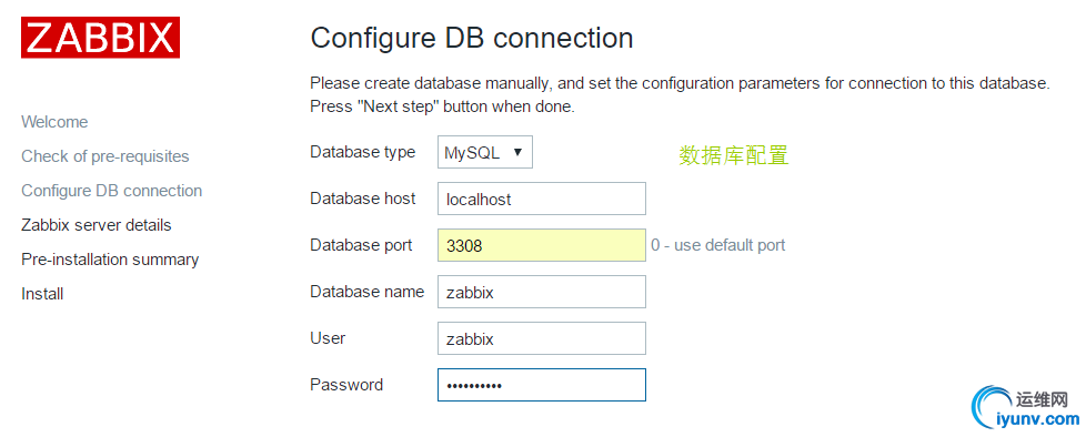

2.4 创建、导入zabbix数据库
tar -xf zabbix-3.0.3.tar.gz
mysql -uroot -p -S /data/3308/mysql.sock
mysql> create database zabbix character set utf8;
mysql> grant all on zabbix.* to 'zabbix'@'localhost' identified by '123456' with grant option;
mysql > flush privileges;
mysql -uzabbix -p123456 -hlocalhost zabbix </root/src/zabbix-3.0.3/database/mysql/schema.sql  导入数据库,一定要按顺序导入
mysql -uzabbix -p123456 -hlocalhost zabbix </root/src/zabbix-3.0.3/database/mysql/images.sql
mysql -uzabbix -p123456 -hlocalhost zabbix </root/src/zabbix-3.0.3/database/mysql/data.sql
2.5 安装zabbix

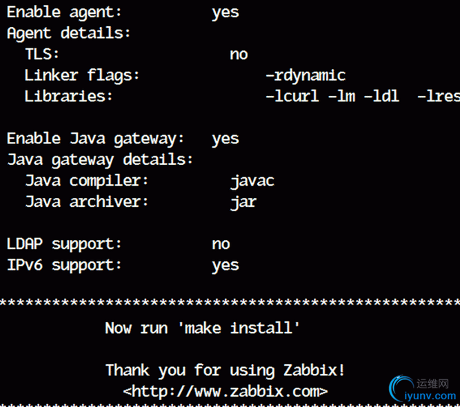

2.5.2 编译安装
cd src/zabbix-3.0.3/
./configure --prefix=/usr/local/zabbix --enable-server --enable-agent --with-net-snmp --with-libcurl --enable-proxy --with-mysql=/usr/local/mysql/bin/mysql_config --enable-java --enable-ipv6 --with-libxml2
make install
ln -s /usr/local/zabbix/sbin/* /usr/local/sbin/   添加系统软连接,这样不用去配置环境变量
ln -s /usr/local/zabbix/bin/* /usr/local/bin/

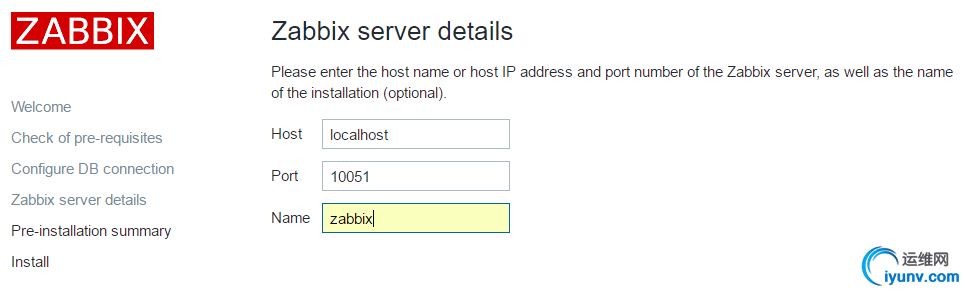

service zabbix_server restart
service zabbix_agentd restart
http://120.76.99.170/zabbix/setup.php

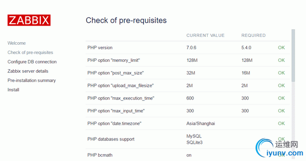

如果提提示缺少gd-jpeg,gd-freetype这些请按下面修复,动态编译php模块
cd src/php-7.0.6/ext/gd/
phpize./configure --with-php-config=/usr/local/php/bin/php-config --with-jpeg-dir --with-freetype-dir
make && make install
然后在php.ini添加模块支持
extention = gd.so
其他php参数配置:
vim /usr/local/php/etc/php.ini
max_execution_time =600
max_input_time =300
memory_limit =128M
post_max_size =32M
date.timezone =Asia/Shanghai

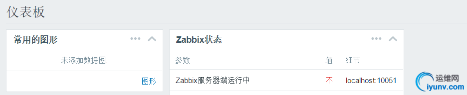

然而发现:
服务并没有启动
排错了,首先看日志,妈蛋,这我也知道。关键是服务没启动,日志压根没生成。其实还是有的,在/tmp/zabbix_server.log
应该是mysql共享库的问题
echo "/usr/local/mysql/lib" >> /etc/ld.so.conf
ldconfig
systemctl restart zabbix_server
systemctl restart zabbix_agentd
lsof -i :10050
lsof -i :10051
提示:排除可以直接运行zabbix_server,zabbix_agentd命令,会打印出报错信息
