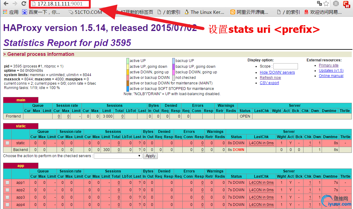

统计接口启用相关的参数:
stats enable:启用统计页;可以基于默认参数直接启用统计页;默认参数如下,其实,只需这一个指令即可,其它都有默认值;
默认设置:
        stats uri   : /haproxy?stats
        stats realm : "HAProxy Statistics"
        stats auth  : no authentication
        stats scope : no restriction
定义访问haproxy的状态页uri,例如:
listen stats *:9001
    stats enable
    stats uri /
    stats realm haproxy\ statistics
    stats auth admin:pass
    stats admin if TRUE
浏览器输入:http://172.18.11.111:9001/
stats uri <prefix>:统计页的访问时的uri前缀,通常要跟上?stats;默认为/haproxy?stats;不建议使用默认公开的状态统计页uri;

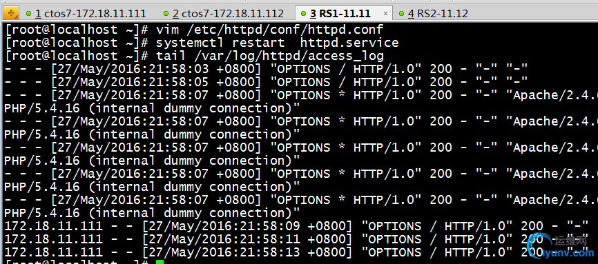

option forwardfor [ except <network> ] [ header <name> ] [ if-none ]
把发往backend server的请求报文中添加X-Forwarded-For首部,其值为真正的客户端主机地址;此功能自动实现;
对于后端主机每一次访问日志信息中记录的客户端是代理服务器的ip地址,应该想要记录真正的客户端ip地址;
except <network>:来自于此网络的请求不添加;
header <name>:不使用默认的X-Forwarded-For,自定义的首部名称;即改名;
例如:
后端RS1,httpd配置文件,修改日志格式:
]# vim /etc/httpd/conf/httpd.conf
LogFormat "%{X-Forwarded-For}i %l %u %t \"%r\" %>s %b \"%{Referer}i\" \"%{User-Agent}i\"" combined

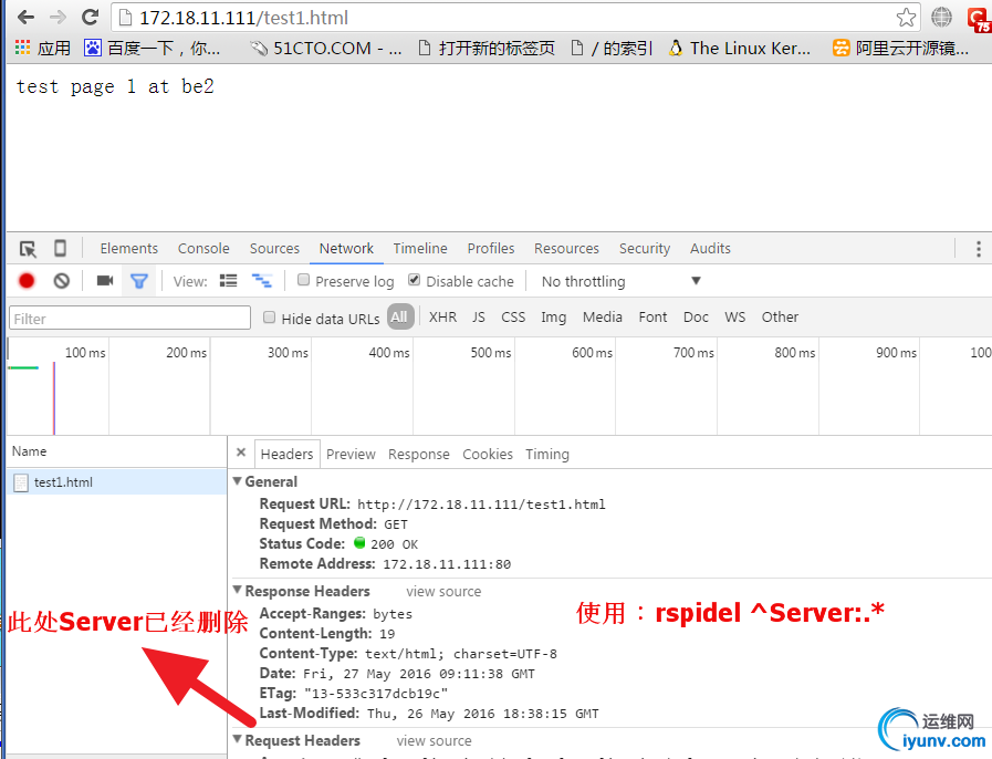

删除响应给客户端首部的Server的值,例如:
listen web
    log global
    bind *:80,*:8080
    balance roundrobin
    option httpchk
    maxconn 7700
    rspidel ^Server:.*
    errorfile 403 /tmp/403.html
    cookie web insert indirect nocache
    server web-RS1 172.18.11.11:80 check weight 1 maxconn 2000 maxqueue 200 cookie rs1
    server web-RS2 172.18.11.12:80 check weight 2 maxconn 5000 maxqueue 500 cookie rs2

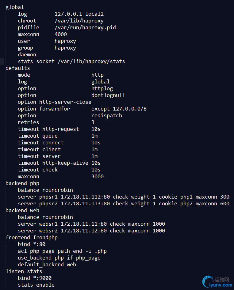

haproxy实现简单的动静分离:
]# vim /etc/haproxy/haproxy.cfg
backend php
    balance roundrobin
#   cookie phpsession indirect nocache
    server phpsr1 172.18.11.112:80 check weight 1 cookie php1 maxconn 300
    server phpsr2 172.18.11.113:80 check weight 1 cookie php2 maxconn 600
backend web
    balance roundrobin
    server websr1 172.18.11.11:80 check maxconn 1000
    server websr2 172.18.11.12:80 check maxconn 1000
frontend frondphp
    bind *:80
    acl php_page path_end -i .php
#   acl php_page path_reg -i \.php$
    use_backend php if php_page
    default_backend web
listen stats
    bind *:9000
    stats enable
