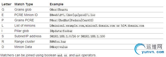

[iyunv@centos salt]# salt -C 'G@os:ubuntu' test.ping
server.hadoop.com:
True
[iyunv@centos salt]# salt -C 'E@server.\w+' test.ping
server.hadoop.com:
True
[iyunv@centos salt]# salt -C 'P@os:(centos)' test.ping
localhost:
    True
[iyunv@centos salt]# salt -C 'P@os:(centos|ubuntu)' test.ping
server.hadoop.com:
    True
localhost:
True
[iyunv@centos salt]# salt -C 'L@localhost,server.hadoop.com' test.ping
server.hadoop.com:
    True
localhost:
True
[iyunv@centos salt]# salt -C 'S@192.168.56.0/24' test.ping
server.hadoop.com:
    True
localhost:
True

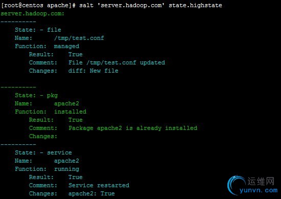

运行的话,可以使用salt 'localhost' state.highstate
注意,如果需要把服务设置为开机启动可以使用- enable:True
由于我设置的是有变化就重启http,所以先查看http的状态
10
11
12
13
14
[iyunv@centos salt]# ps -ef|grep httpd
root      1430     1  0 17:03 ?        00:00:00 /usr/sbin/httpd
apache    1436  1430  0 17:03 ?        00:00:00 /usr/sbin/httpd
apache    1469  1430  0 17:03 ?        00:00:00 /usr/sbin/httpd
apache    1470  1430  0 17:03 ?        00:00:00 /usr/sbin/httpd
apache    1471  1430  0 17:03 ?        00:00:00 /usr/sbin/httpd
apache    1472  1430  0 17:03 ?        00:00:00 /usr/sbin/httpd
apache    1473  1430  0 17:03 ?        00:00:00 /usr/sbin/httpd
apache    1474  1430  0 17:03 ?        00:00:00 /usr/sbin/httpd
apache    1475  1430  0 17:03 ?        00:00:00 /usr/sbin/httpd
apache    1476  1430  0 17:03 ?        00:00:00 /usr/sbin/httpd
root      1886  1782  0 17:04 pts/0    00:00:00 grep httpd
[iyunv@centos salt]# date
Fri Aug  9 17:04:54 CST 2013
在17:04启动,然后在运行salt 'localhost' state.highstate
10
11
12
13
14
15
16
17
18
19
20
21
22
23
24
25
26
27
28
29
[iyunv@centos salt]# salt 'localhost' state.highstate
Info: Running a benchmark to measure system clock frequency...
Info: Finished RDTSC test. To prevent the startup delay from this benchmark, set the environment variable RDTSC_FREQUENCY to 2495 on this system. This value is dependent upon the CPU clock speed and architecture and should be determined separately for each server.
localhost:
    State: - file
    Function:  managed
        Result:    True
        Comment:   File /tmp/test_echoping.conf updated
        Changes:   diff: New file
    State: - pkg
    Function:  installed
        Result:    True
        Comment:   The following packages were installed/updated: echoping.
        Changes:   echoping: { new : 5.2.0-1.2.el6.rf
old :
    State: - service
    Function:  running

然后运行更新
10
11
12
13
14
15
16
17
18
19
20
21
22
23
24
[iyunv@centos apache]# salt 'server.hadoop.com' state.highstate
server.hadoop.com:
    State: - file
    Function:  managed
        Result:    True
        Comment:   File /tmp/test.conf updated
    State: - pkg
    Function:  installed
        Result:    True
        Comment:   Package apache2 is already installed
        Changes:
    State: - service
    Function:  running
        Result:    True
        Comment:   Service restarted
        Changes:   apache2: True
