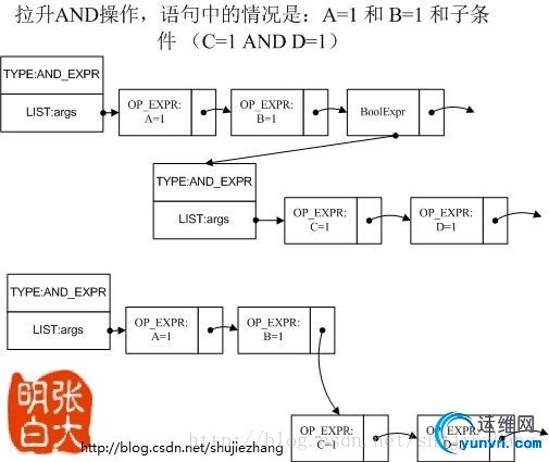

pull_ands()和pull_ors()的代码比较便于理解,就是把树状结构的AND操作拉平,下图是pull_ands的例子,pull_ors逻辑相同:
     * pull_ands
     *    Recursively flatten nested AND clauses into a single and-clause list.
     * Input is the arglist of an AND clause.
     * Returns the rebuilt arglist (note original list structure is not touched).
    static List *
    pull_ands(List *andlist)
        List       *out_list = NIL;
        ListCell   *arg;
        foreach(arg, andlist)
            Node       *subexpr = (Node *) lfirst(arg);
             * Note: we can destructively concat the subexpression's arglist
             * because we know the recursive invocation of pull_ands will have
             * built a new arglist not shared with any other expr. Otherwise we'd
             * need a list_copy here.
            if (and_clause(subexpr))
                out_list = list_concat(out_list,
                                       pull_ands(((BoolExpr *) subexpr)->args));
            else
                out_list = lappend(out_list, subexpr);
        return out_list;
     * pull_ors
     *    Recursively flatten nested OR clauses into a single or-clause list.
     * Input is the arglist of an OR clause.
    static List *
    pull_ors(List *orlist)
        ListCell   *arg;
        foreach(arg, orlist)
             * because we know the recursive invocation of pull_ors will have
            if (or_clause(subexpr))
                                       pull_ors(((BoolExpr *) subexpr)->args));
            else
        return out_list;
