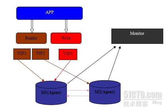

环境:
MMM_Monitor: 192.168.8.31-----(MySQL-MON)
MySQL_Master1: 192.168.8.32-----(MySQL-M1)
MySQL_Master2: 192.168.8.33-----(MySQL-M2)
VIP_Write: 192.168.8.30-----(VIP0)
VIP_Read1: 192.168.8.34-----(VIP1)
VIP_Read2: 192.168.8.35-----(VIP2)
架构原理图:
