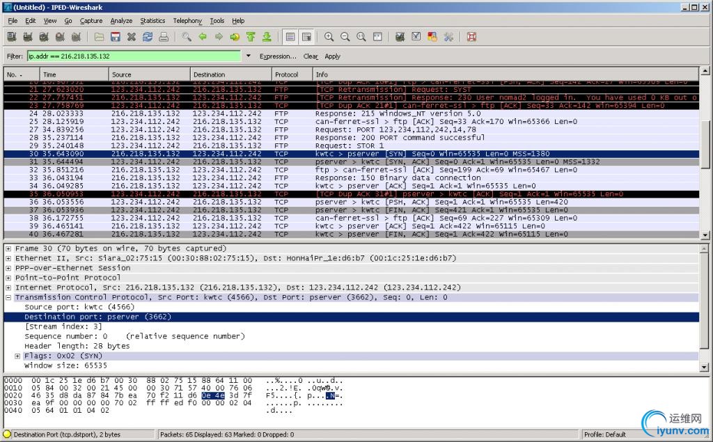

  4. 连接管理
  1) port command, client need to upload a file, and selected port is 3662.
  2) server response, OK
  3) client run "put 1", and server setup a TCP connection for Data transfer, and selected port is 4566.
  4) after data transfer done, client close the TCP connection, then server close the TCP connection, and server response with 226, transfer complete.
