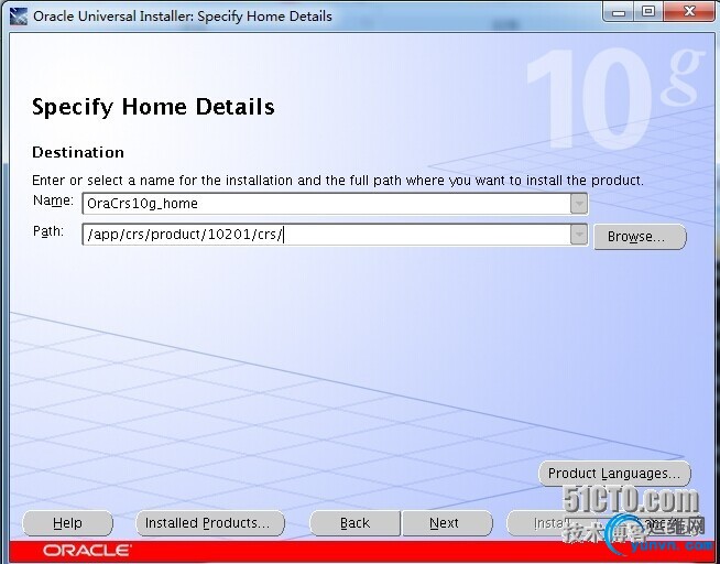

export ORACLE_BASE=/u01/oracle
export ORACLE_HOME=$ORACLE_BASE/product/10201/rac_db
export ORA_CRS_HOME=/app/crs/product/10201/crs

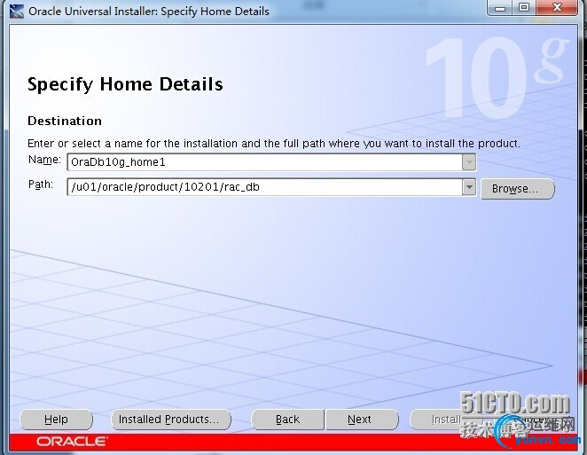

[iyunv@node-rac1 ~]# mkdir  -p /u01/oracle/product/10201/rac_db
[iyunv@node-rac1 ~]# mkdir  -p /app/crs/product/10201/crs

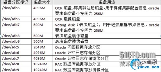

13.启动LINUX进行分区
[iyunv@node-rac1 ~]# fdisk /dev/sdb
Device contains neither a valid DOS partition table, nor Sun, SGI or OSF disklabel
Building a new DOS disklabel. Changes will remain in memory only,
until you decide to write them. After that, of course, the previous
content won't be recoverable.
The number of cylinders for this disk is set to 1958.
There is nothing wrong with that, but this is larger than 1024,
and could in certain setups cause problems with:
1) software that runs at boot time (e.g., old versions of LILO)
2) booting and partitioning software from other OSs
   (e.g., DOS FDISK, OS/2 FDISK)
Warning: invalid flag 0x0000 of partition table 4 will be corrected by w(rite)
Command (m for help): n
Command action
   e   extended
   p   primary partition (1-4)
e
Partition number (1-4): 1
First cylinder (1-1958, default 1):
Using default value 1
Last cylinder or +size or +sizeM or +sizeK (1-1958, default 1958):
Using default value 1958
Command action
   l   logical (5 or over)
l
Last cylinder or +size or +sizeM or +sizeK (1-1958, default 1958): +4096
Value out of range.
Last cylinder or +size or +sizeM or +sizeK (1-1958, default 1958): +4096M
Command action
l
First cylinder (500-1958, default 500):
Using default value 500
Last cylinder or +size or +sizeM or +sizeK (500-1958, default 1958): +4096M
Command (m for help): N
Command action
l
First cylinder (999-1958, default 999):
Using default value 999
Last cylinder or +size or +sizeM or +sizeK (999-1958, default 1958): +500M
Command action
l
First cylinder (1061-1958, default 1061):
Using default value 1061
Last cylinder or +size or +sizeM or +sizeK (1061-1958, default 1958): +500M
Command action
l
First cylinder (1123-1958, default 1123):
Using default value 1123
Last cylinder or +size or +sizeM or +sizeK (1123-1958, default 1958): +500M
Command (m for help): P
Disk /dev/sdb: 16.1 GB, 16106127360 bytes
255 heads, 63 sectors/track, 1958 cylinders
Units = cylinders of 16065 * 512 = 8225280 bytes
   Device Boot      Start         End      Blocks   Id  System
/dev/sdb1               1        1958    15727603+   5  Extended
/dev/sdb5               1         499     4008154+  83  Linux

14.建立和配置raw设备(两台都要操作)最后面增加如下:
[iyunv@node-rac1 ~]# vi /etc/udev/rules.d/60-raw.rules
ACTION=="add",KERNEL=="sdb5",RUN+="/bin/raw /dev/raw/raw1 %N"
ACTION=="add",KERNEL=="sdb6",RUN+="/bin/raw /dev/raw/raw2 %N"
ACTION=="add",KERNEL=="sdb7",RUN+="/bin/raw /dev/raw/raw3 %N"
ACTION=="add",KERNEL=="sdb8",RUN+="/bin/raw /dev/raw/raw4 %N"
ACTION=="add",KERNEL=="sdb9",RUN+="/bin/raw /dev/raw/raw5 %N"
ACTION=="add",KERNEL=="sdc5",RUN+="/bin/raw /dev/raw/raw6 %N"
ACTION=="add",KERNEL=="sdc6",RUN+="/bin/raw /dev/raw/raw7 %N"
ACTION=="add",KERNEL=="sdc7",RUN+="/bin/raw /dev/raw/raw8 %N"
ACTION=="add",KERNEL=="sdc8",RUN+="/bin/raw /dev/raw/raw9 %N"
ACTION=="add",KERNEL=="sdc9",RUN+="/bin/raw /dev/raw/raw10 %N"
KERNEL=="raw1", OWNER="oracle", GROUP="oinstall", MODE="660"
KERNEL=="raw2", OWNER="oracle", GROUP="oinstall", MODE="660"
KERNEL=="raw3", OWNER="oracle", GROUP="oinstall", MODE="644"
KERNEL=="raw4", OWNER="oracle", GROUP="oinstall", MODE="644"
KERNEL=="raw5", OWNER="oracle", GROUP="oinstall", MODE="644"
KERNEL=="raw6", OWNER="oracle", GROUP="oinstall", MODE="660"
KERNEL=="raw7", OWNER="oracle", GROUP="oinstall", MODE="660"
KERNEL=="raw8", OWNER="oracle", GROUP="oinstall", MODE="660"
KERNEL=="raw9", OWNER="oracle", GROUP="oinstall", MODE="660"
KERNEL=="raw10", OWNER="oracle", GROUP="oinstall", MODE="660"

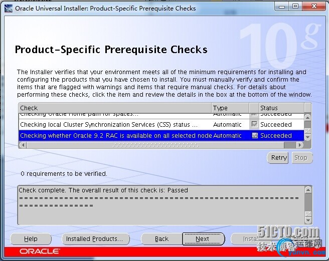

16.验证环境
[oracle@node-rac1 ~]$ cd clusterware/cluvfy/
[oracle@node-rac1 cluvfy]$ ./runcluvfy.sh stage -pre crsinst -n node-rac1,node-rac2 -verbose
出现
ERROR:
Could not find a suitable set of interfaces for VIPs. 这是10.2 RAC bug,后面会解决。
安装RAC前,我们需要安装远程桌面软件。使用Xmanager远程桌面登录(这个后期写给大家)

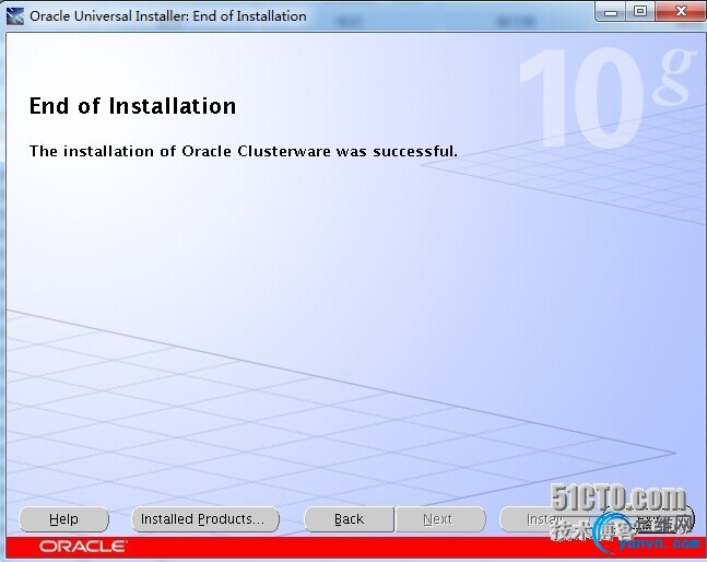

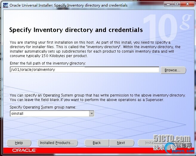

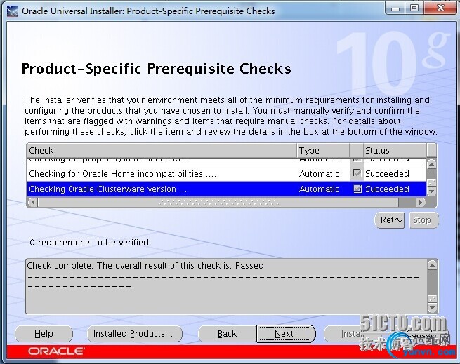

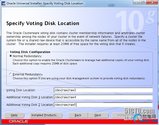

17.安装oracle clusterware

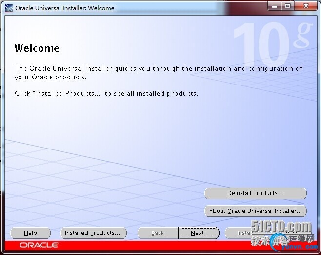

[oracle@node-rac1 clusterware]$ ./runInstaller
Next
Next目录和上图片一样
目录/app/crs/product/10201/crs     Next下一步

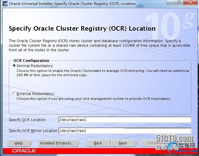

Next

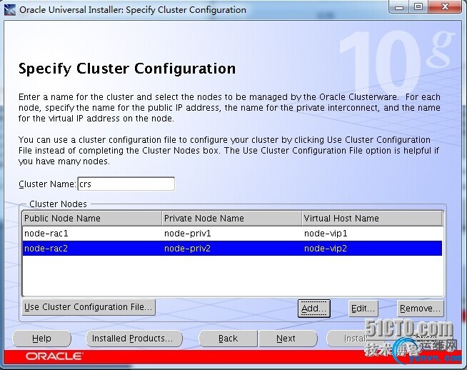

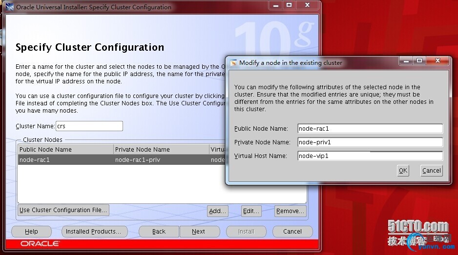

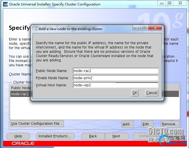

Edit修改后如上图OK
Add增加第二个节点如上图修改后OK
Next

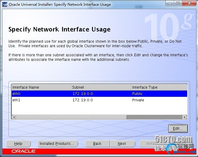

修改成上图一样,Next
如上图 Next

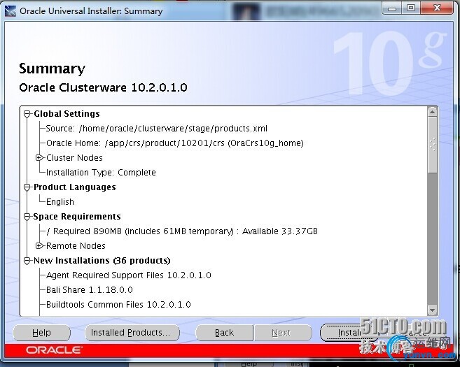

Next

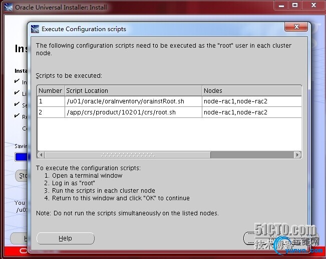

Install
如上图所示,用root用户分别执行上面脚本
[iyunv@node-rac1 ~]# /u01/oracle/oraInventory/orainstRoot.sh
Changing permissions of /u01/oracle/oraInventory to 770.
Changing groupname of /u01/oracle/oraInventory to oinstall.
The execution of the script is complete
[iyunv@node-rac2 ~]# /u01/oracle/oraInventory/orainstRoot.sh
[iyunv@node-rac1 ~]# /app/crs/product/10201/crs/root.sh

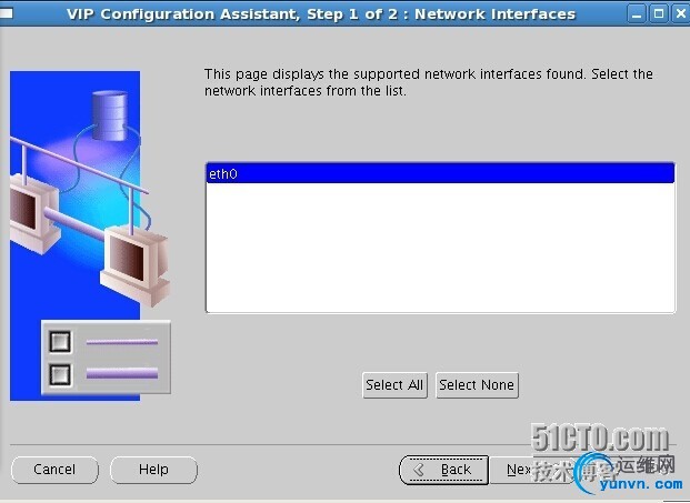

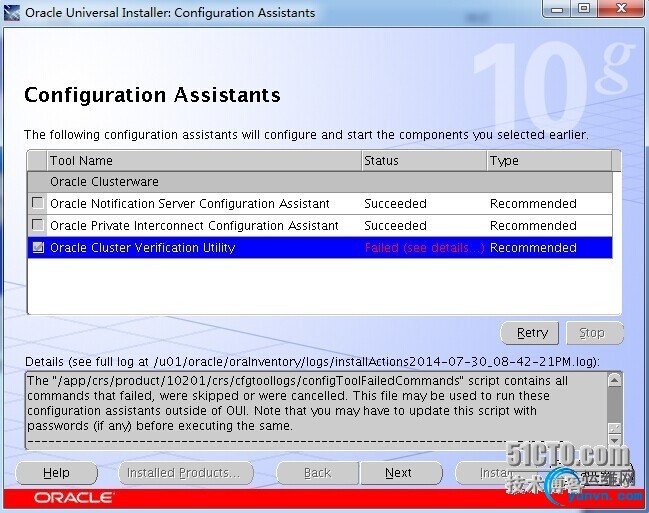

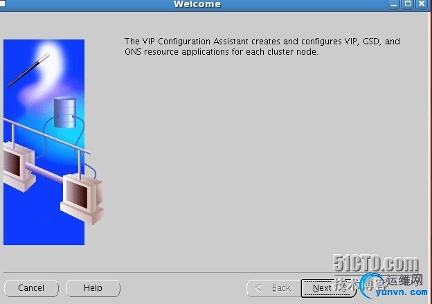

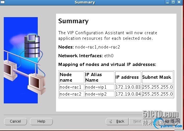

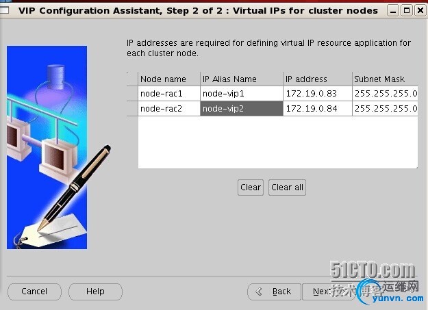

18.root用户下安装vip
next
next
IP Alias Name 修改成node-vip1,node-vip2 点击Next

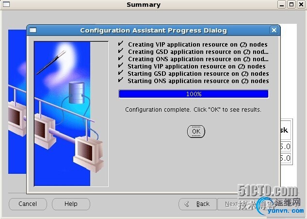

Finish
说明vip安装成功,点击ok
点击Retry一下
wKiom1PYq8LzAuffAAHqL2nDdeU357.jpg 说明cluster成功了,点击Exit

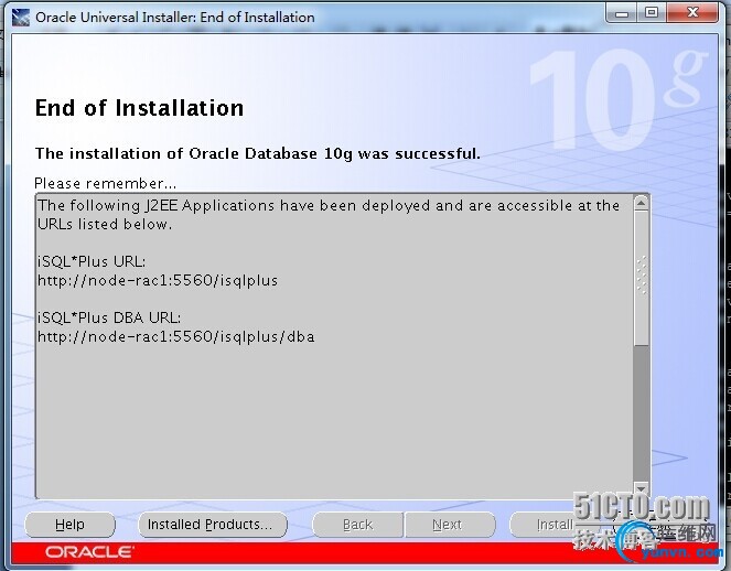

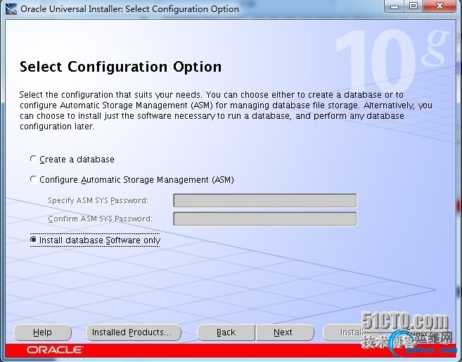

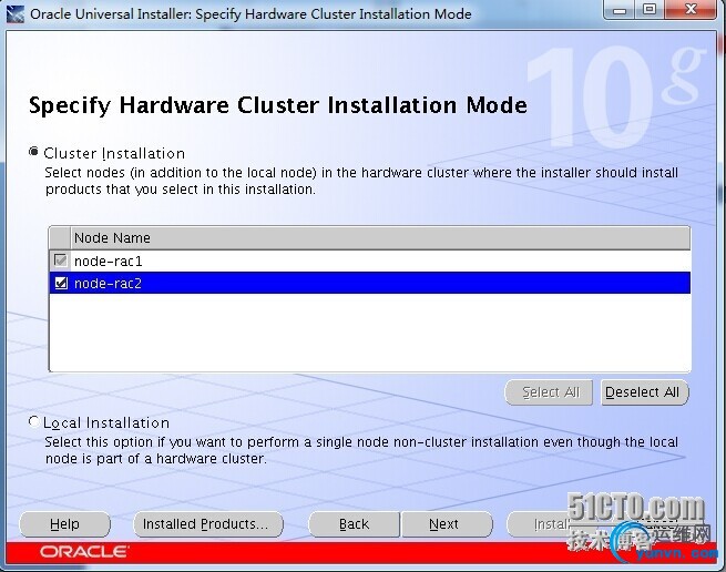

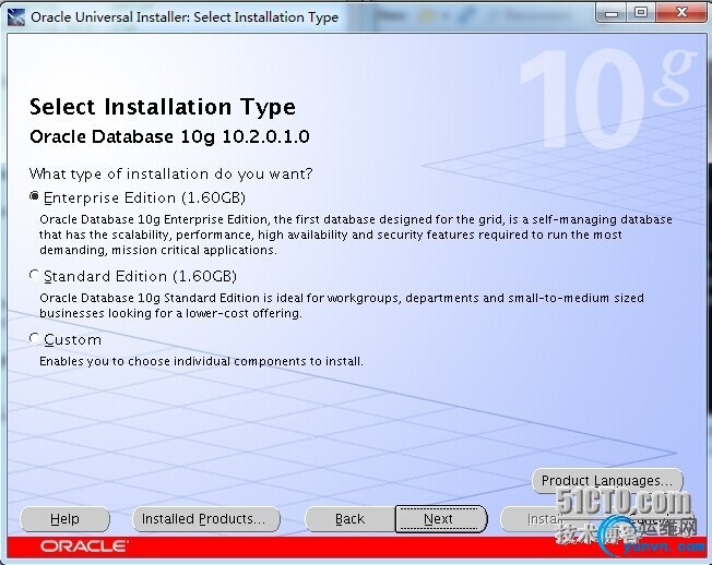

19.安装Oracle 数据库软件
[oracle@node-rac1 database]$ ./runInstaller
Next
修改成上图,Next
把node-rac2点上,Next
Next
选择Install database software only 点击Next

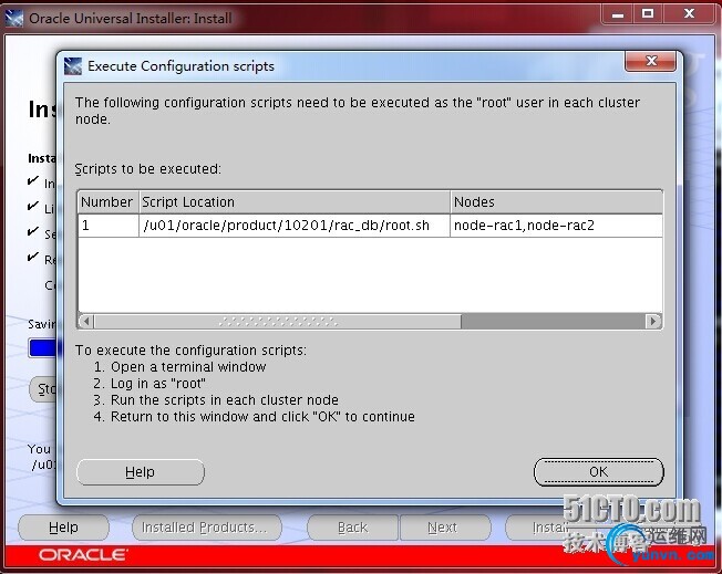

采用root用户分别执行
[iyunv@node-rac1 bin]# /u01/oracle/product/10201/rac_db/root.sh
[iyunv@node-rac2 rac_db]# /u01/oracle/product/10201/rac_db/root.sh
点击OK
上图说明安装成功,点击Exit

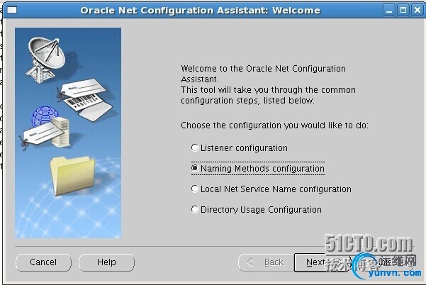

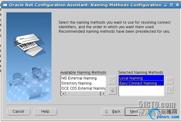

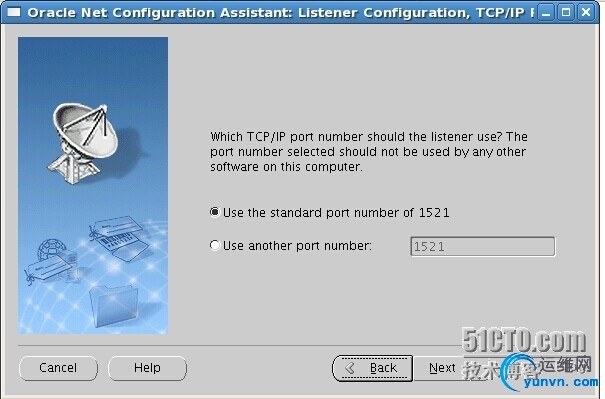

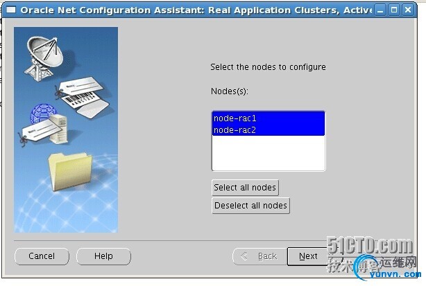

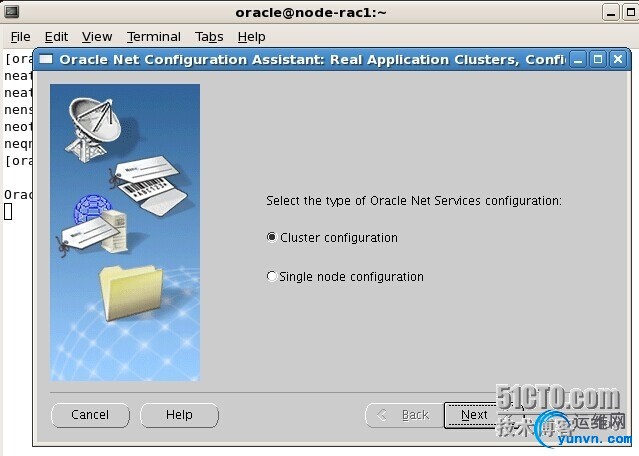

20.配置Oracle Net
[oracle@node-rac1 database]$ cd /u01/oracle/product/10201/rac_db/bin/
[oracle@node-rac1 bin]$ ./netca
Next
wKiom1PYrMKynMPFAAGC9hcMg6I630.jpg Next一直下一步到下面图
Next一直Next
Next
Next Next Finish

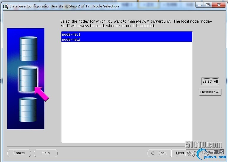

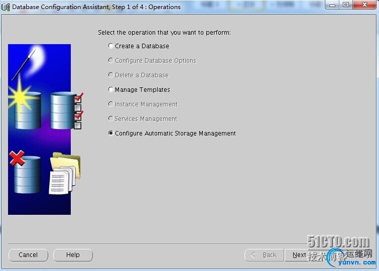

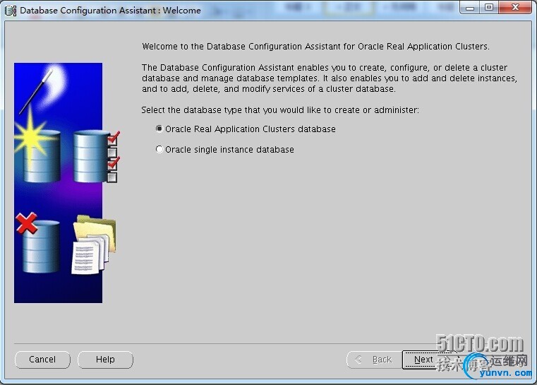

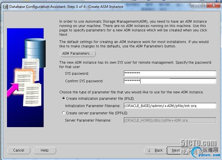

[oracle@node-rac1 ~]$ /u01/oracle/product/10201/rac_db/bin/dbca

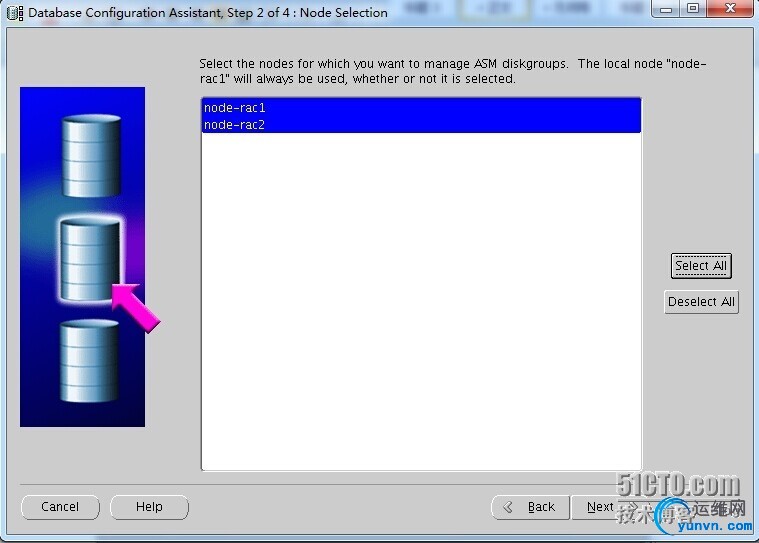

Next
选择configure Automatic storage Managemen 点击Next
点击select all 在点击 Next

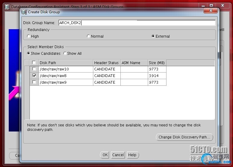

设置ASM实例sys用户口令  NEXT

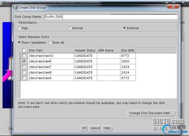

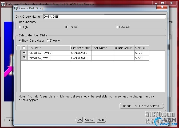

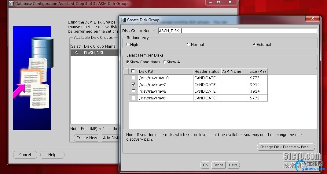

单击Create New按钮,创建ASM
这里输入磁盘级名称为"FLASH_DISK",然后选择冗余策略为"Eexternal",最后选择磁盘设备"/dev/raw/raw6",点击OK
create new 在配置如图片,OK
如图OK

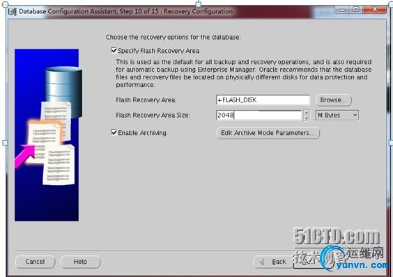

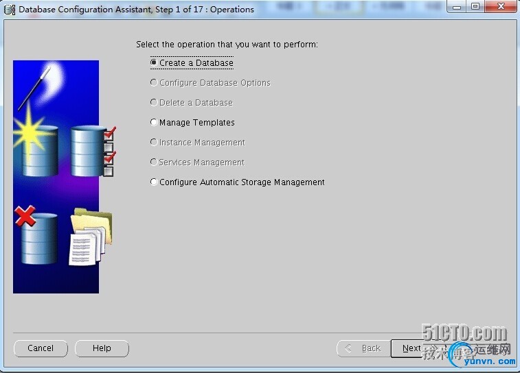

后面点击finish按钮

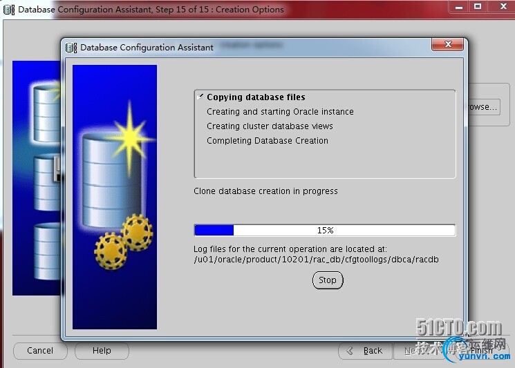

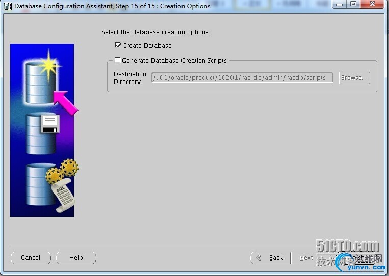

选择 create database 点击next

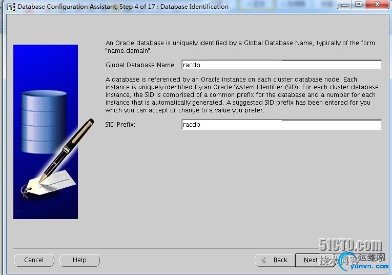

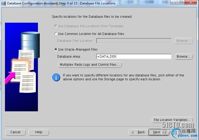

点select All 在点击Next

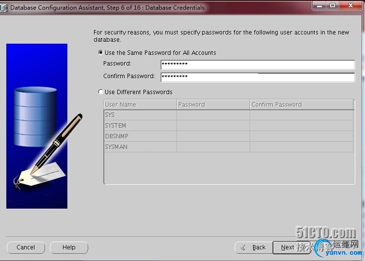

SID为racdb 点击Next
输入口令在Next
选择Automa (ASM) 点击Next

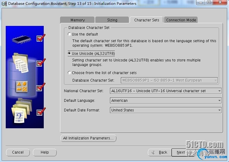

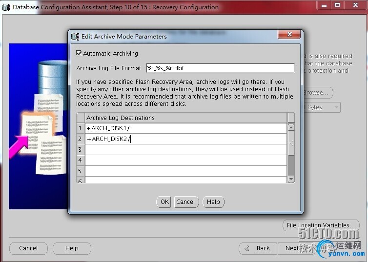

修改成如上图Next

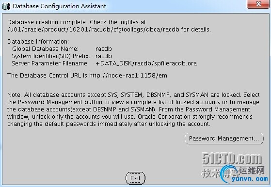

Finish
可以进行密码修改操作
点击Exit结束安装
[oracle@node-rac1 ~]$ crs_stat -t
