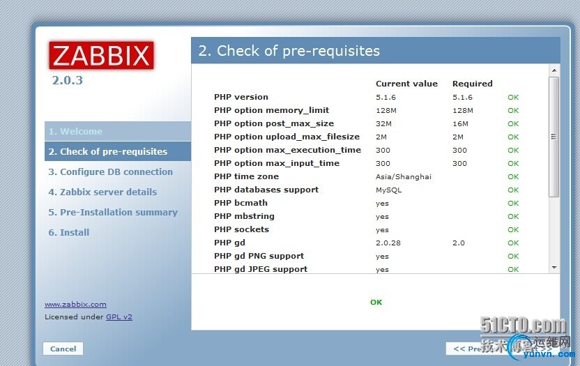

修改php配置文件
[iyunv@zabbix111 frontends]# vi /etc/php.ini
date.timezone = Asia/Shanghai
max_execution_time = 300
max_input_time = 300
post_max_size = 32M
mbstring.func_overload = 2
修改完成后重启apache
[iyunv@zabbix111 frontends]# service httpd restart
[iyunv@zabbix111 frontends]# /etc/init.d/iptables stop #防火墙关闭
[iyunv@zabbix111 frontends]# chkconfig iptables off
开机启动
[iyunv@zabbix111 frontends]# chkconfig mysqld on
[iyunv@zabbix111 frontends]# chkconfig httpd on

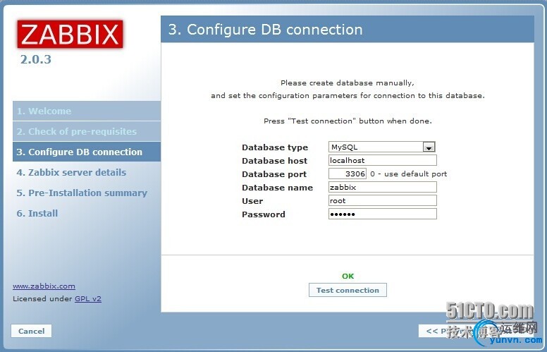

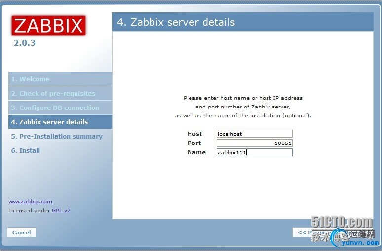

打开浏览器
Next
Next
Next
Next
Download下来放在/var/www/html/zabbix/conf目录下后面点击Retry后,在点击Finish
