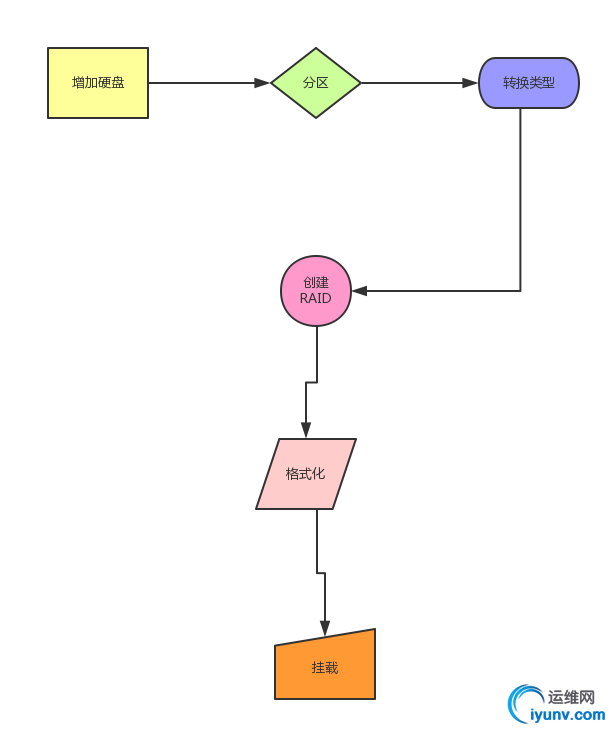

    一、准备用于RAID阵列的分区
    (一)增加硬盘、分区(关掉虚拟机的情况下,增加硬盘)
        A.增加硬盘(虚拟机是这样,真机是需要加硬盘)
        B.对“/dev/sde1、/dev/sdg1、/dev/sdh1、/dev/sdf1、/dev/sd ”进行分区以及检验分区信息
        C.转换类型为Linux raid autodetect(fd)以及查看转换后的信息

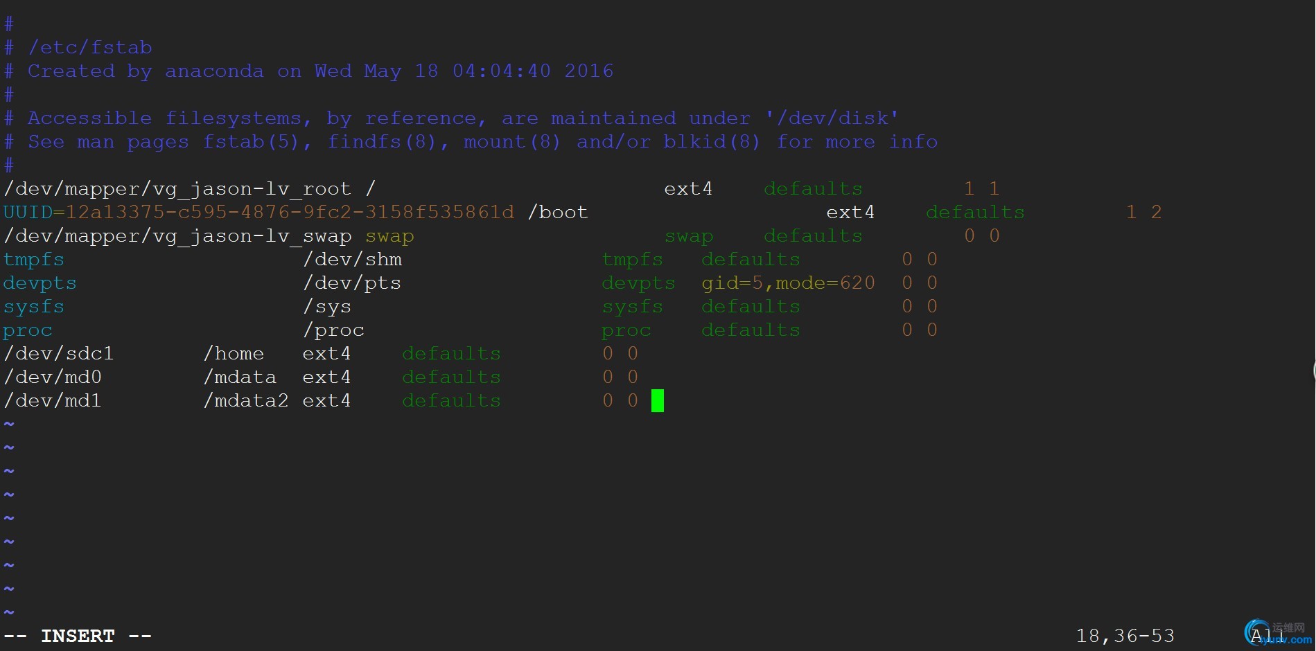

    五、修改/etc/fstab文件,实现开机自动启动
        修改fstab配置文件,达到开机后自动挂载的目的。
        A.备份fstab
        B.修改文件
        C.测试修改的效果
            卸载
            重新挂载
            查看挂载信息
1.先备份一下fstab文件
[iyunv@test2 etc]# cp fstab fstab.bak2
2.更改配置文件
[iyunv@test2 etc]# vim fstab
[iyunv@test2 etc]#
3.测试是否奏效:
a.先卸载并查看挂载信息:
[iyunv@test2 etc]# umount /dev/md1
[iyunv@test2 etc]# mount | grep "md1"
b.挂载,并查看信息:
[iyunv@test2 etc]# mount /mdata2
/dev/md1 on /mdata2 type ext4 (rw)

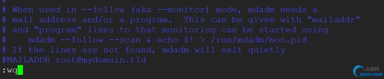

# When used in --follow (aka --monitor) mode, mdadm needs a
# mail address and/or a program.  This can be given with "mailaddr"
# and "program" lines to that monitoring can be started using
#mdadm --follow --scan & echo $! > /run/mdadm/mon.pid
# If the lines are not found, mdadm will exit quietly
#MAILADDR root@mydomain.tld
#PROGRAM /usr/sbin/handle-mdadm-events
  65,1  Bot

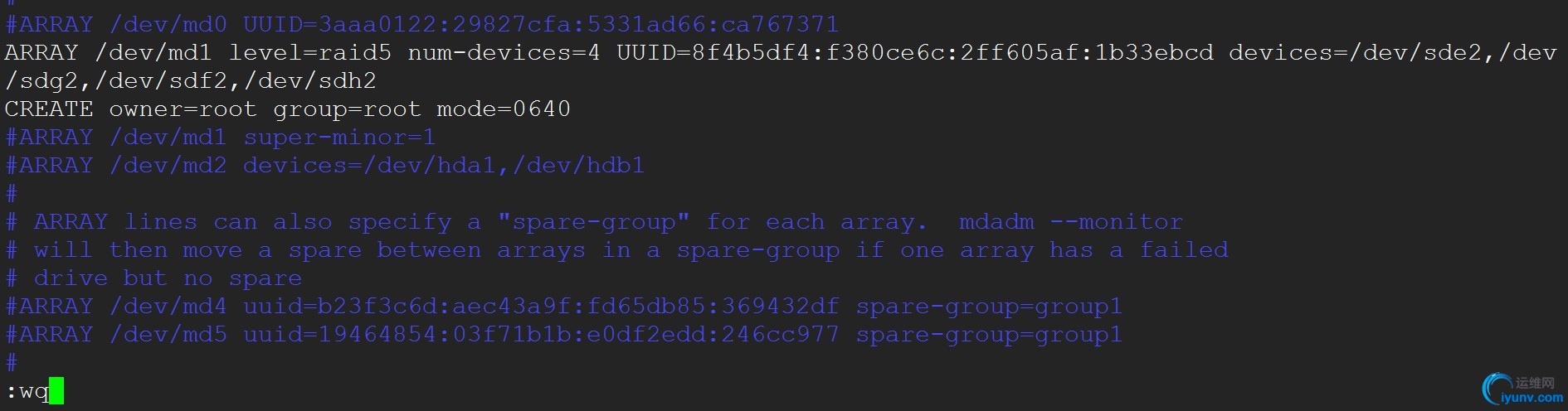

修改:
[iyunv@test2 jason]# mdadm -S /dev/md1
mdadm: unrecognised word on ARRAY line: levle=raid5
mdadm: Unknown keyword devices=/dev/sde2,/dev/sdg2,/dev/sdf2,/dev/sdh2
mdadm: Cannot get exclusive access to /dev/md1:Perhaps a running process, mounted filesystem or active volume group?
分析:这里有两个错误
    拼写错误
    devices是未知的关键字
man mdadm.conf
devices=
The value is a comma separated list of device names or device name pat-terns. Only devices with names which match one entry in the list will be used to assemble the array. Note that the devices listed there must also be listed on a DEVICE line.
解释:devices和DEVICE要在一行,才可以被识别。
修改level拼写
[iyunv@test2 jason]# vim /etc/mdadm.conf
修改devices:[iyunv@test2 jason]# vim /etc/mdadm.conf
