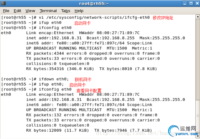

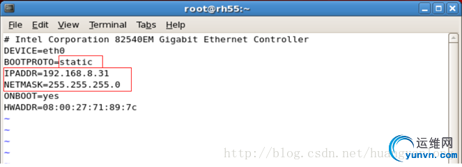

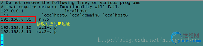

1、 升级准备(1)确认hosts设置【补充】:修改Linux的IP地址
[iyunv@rh55 ~]# vi /etc/hosts

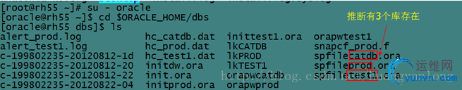

[iyunv@rh55 ~]# su - oracle
[oracle@rh55 ~]$ cd $ORACLE_HOME/dbs
[oracle@rh55 dbs]$ ls

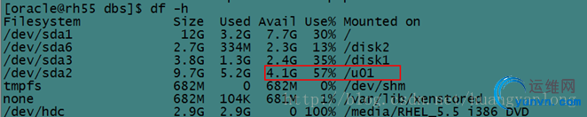

(2)检查磁盘空间
[oracle@rh55 dbs]$ df -h
//u01下只有4g较少,之后升级到11g时需要至少5g以上空间,需给u01增加空间
为了给/u01增加可用空间,将本机内无用数据库卸载,如下:

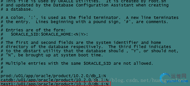

[oracle@rh55 dbs]$ vi /etc/oratab      //为卸载catdb、test1数据库做准备

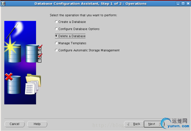

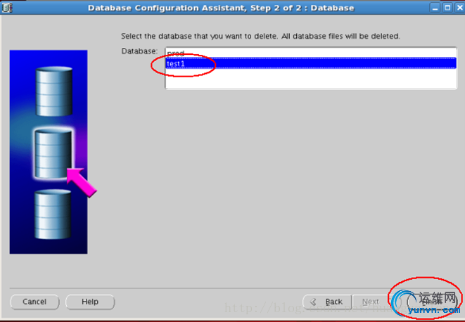

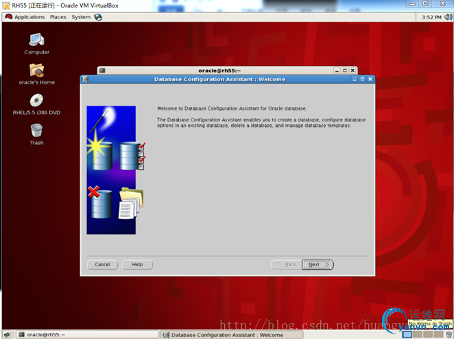

[oracle@rh55 dbs]$ dbca

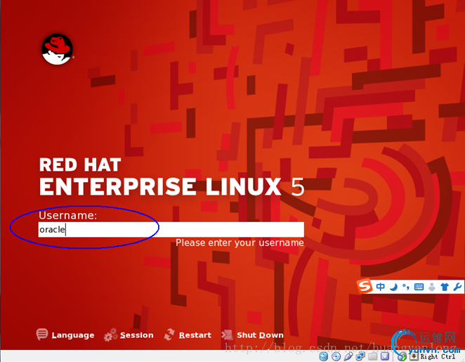

//使用dbca时报错,需要执行export命令,并注销后用oracle用户登陆操作系统
注销系统,使用oracle用户登陆:
$dbca

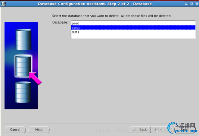

选择删除数据库,如下图:

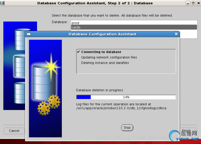

先删除catdb库,如下图:
卸载数据库,如下图所示:
接下来,同样的方法卸载test1数据库,如下图:

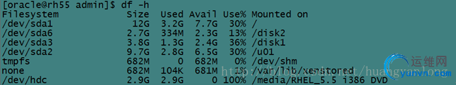

[oracle@rh55 admin]$ df -h   //u01已经变成6.5g,满足了后续安装oracle11g的工作

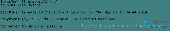

[oracle@rh55 oradata]$ !sql

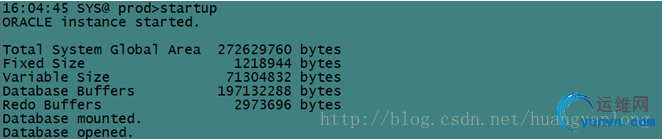

16:04:45 SYS@ prod>startup

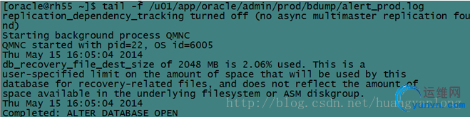

[oracle@rh55 ~]$ tail -f/u01/app/oracle/admin/prod/bdump/alert_prod.log
//开启告警日志文件

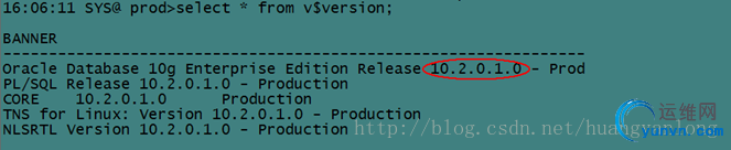

16:06:11SYS@ prod>select* from v$version;

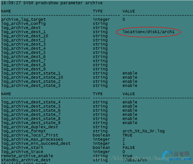

16:09:27 SYS@ prod>show parameter archive
//查看一下归档信息,为了删除无用的归档目录
[iyunv@rh55 oradata]# cd /
[iyunv@rh55 /]# cd disk1
[iyunv@rh55 disk1]# ls
arch1  arch2  backup lost+found  oradata  prod recovery  rman
[iyunv@rh55 disk1]# rm -rf arch2
//因为之前查看到了prod库的归档为arch1,因此推断出arch2为其它库的文件,之前已经将库删除了所以可以将此目录删除

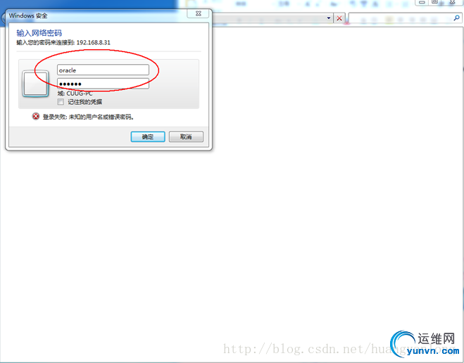

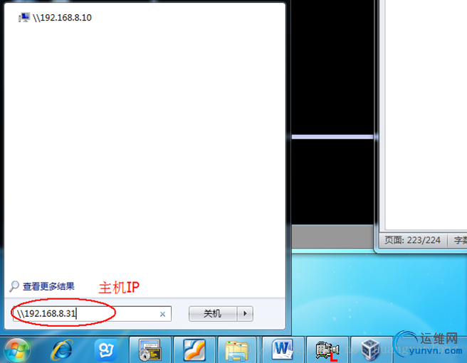

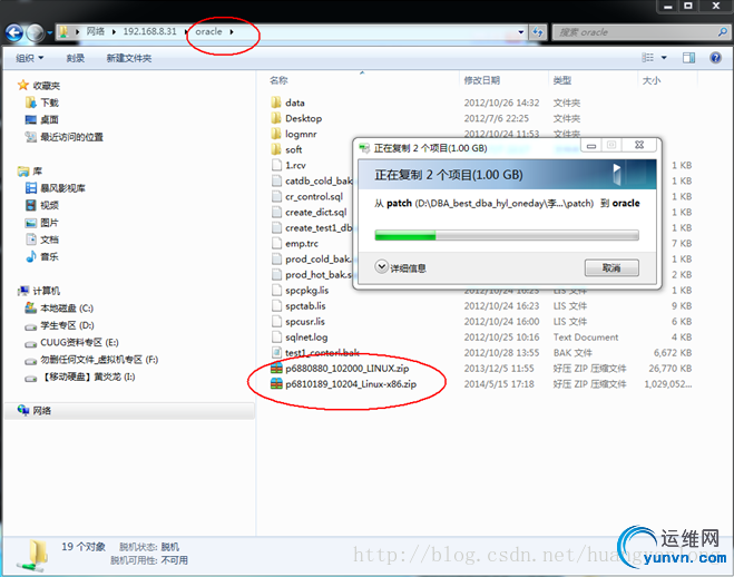

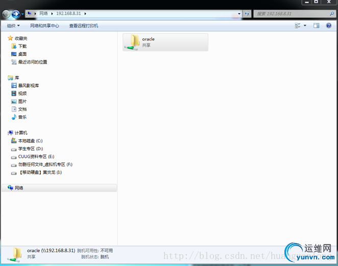

(4)上传升级包方式一:使用samba服务器
[iyunv@rh55 ~]# service smb start         //报错,没有smb服务
smb: unrecognized service
//接下来安装samba服务器

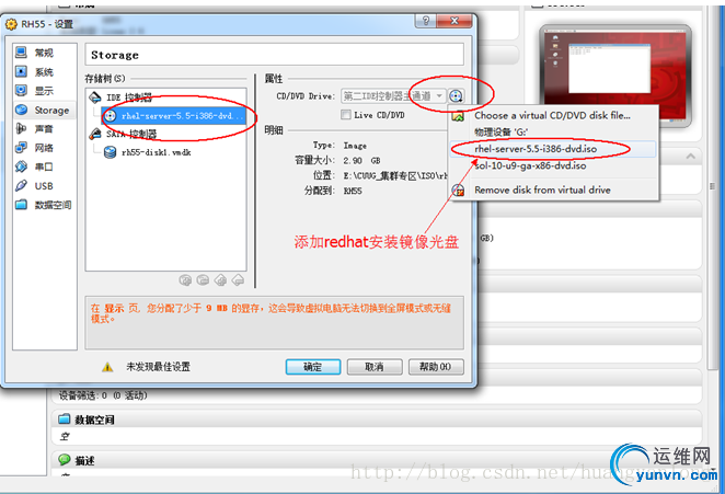

[iyunv@rh55 ~]# mount /dev/cdrom /media/
mount: block device /dev/cdrom iswrite-protected, mounting read-only
[iyunv@rh55 ~]# yum install -y samba-*
Loaded plugins: rhnplugin, security
This system is not registered with RHN.
RHN support will be disabled.
base                                                    | 1.3 kB     00:00
Setting up Install Process
Package samba-common-3.0.33-3.28.el5.i386 alreadyinstalled and latest version
Package samba-client-3.0.33-3.28.el5.i386 alreadyinstalled and latest version
Resolving Dependencies
--> Running transaction check
---> Package samba.i386 0:3.0.33-3.28.el5 setto be updated
--> Processing Dependency: perl(Convert::ASN1)for package: samba
---> Package samba-swat.i386 0:3.0.33-3.28.el5set to be updated
---> Package perl-Convert-ASN1.noarch0:0.20-1.1 set to be updated
--> Finished Dependency Resolution
Dependencies Resolved
Package                 Arch         Version                  Repository  Size
Installing:
samba                   i386         3.0.33-3.28.el5          base        16 M
samba-swat              i386         3.0.33-3.28.el5          base       8.2 M
Installing for dependencies:
perl-Convert-ASN1       noarch       0.20-1.1                 base        41 k
Transaction Summary
Install      3 Package(s)
Upgrade      0 Package(s)
Total download size: 24 M
Downloading Packages:
Total                                           8.1GB/s |  24 MB     00:00
Running rpm_check_debug
Running Transaction Test
Finished Transaction Test
Transaction Test Succeeded
Running Transaction
Installing     :perl-Convert-ASN1                                        1/3
error: failed to stat /media/RHEL_5.5 i386 DVD:No such file or directory
Installing     : samba                                                    2/3
Installing     : samba-swat                                              3/3
Installed:
samba.i386 0:3.0.33-3.28.el5        samba-swat.i386 0:3.0.33-3.28.el5
Dependency Installed:
perl-Convert-ASN1.noarch 0:0.20-1.1
Complete!
Starting SMB services:                                     [  OK  ]
Starting NMB services:                                     [  OK  ]
[iyunv@rh55 ~]# smbpasswd -a oracle
New SMB password:
Retype new SMB password:
Added user oracle.
将补丁包拷贝到共享的oracle目录下,如下所示:

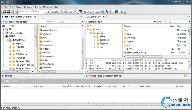

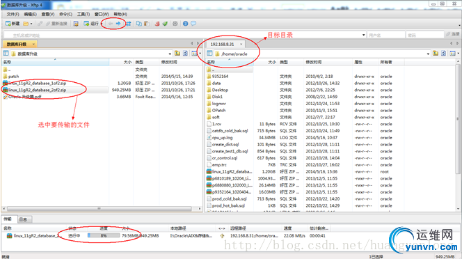

方式二:使用ssh软件使用SecureFX上传软件包,如下图界面:
//与虚拟机建立连接(注意使用oracle用户),将windows下对应的文件拖拽到虚拟机相应目录下
方式三:使用X-manager shell软件 SouthEast.jpg
//至此,补丁包上传完毕(使用以上任意一种方式即可完成)。

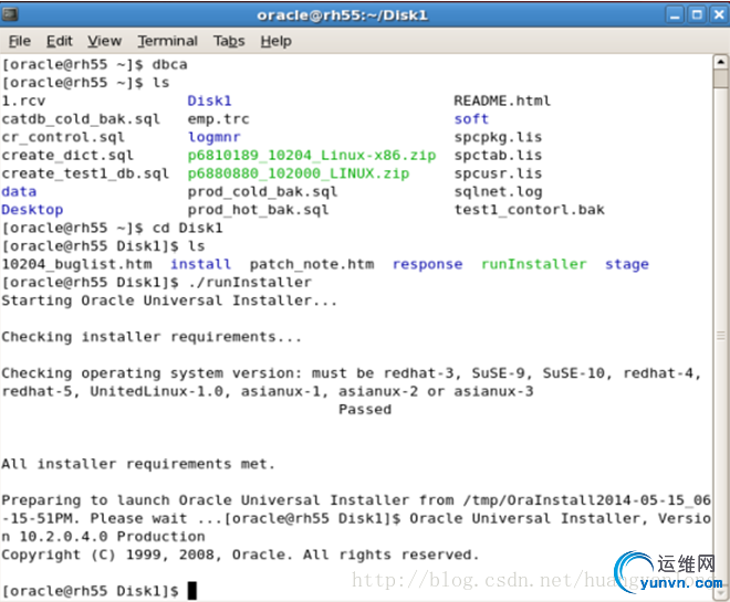

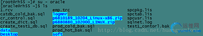

安装包解压:
[oracle@rh55 ~]$ ls
[oracle@rh55 ~]$ unzip p6810189_10204_Linux-x86.zip         //对第一个补丁包解压

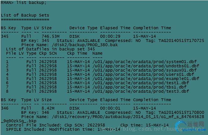

(5)做一次冷备
[oracle@rh55 ~]$ rman target /

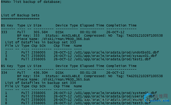

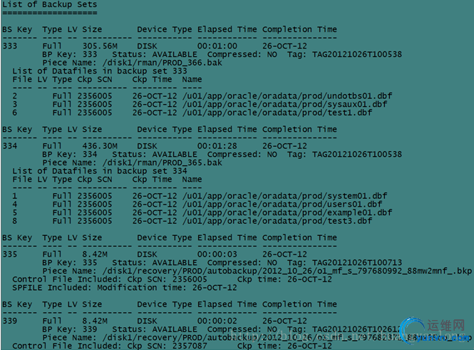

RMAN> list backup;
RMAN> list backup of database;    //旧的备份信息
RMAN> list copy;
RMAN> delete backup;
allocated channel: ORA_DISK_1
channel ORA_DISK_1: sid=154 devtype=DISK
List of Backup Pieces
BP Key  BSKey  Pc# Cp# Status      Device Type Piece Name
333    333     1   1  AVAILABLE   DISK        /disk1/rman/PROD_366.bak
334    334     1   1  AVAILABLE   DISK        /disk1/rman/PROD_365.bak
335    335     1   1  AVAILABLE   DISK       /disk1/recovery/PROD/autobackup/2012_10_26/o1_mf_s_797680992_88mw2mnf_.bkp
339    339     1   1  AVAILABLE   DISK       /disk1/recovery/PROD/autobackup/2012_10_26/o1_mf_s_797682372_88mx65co_.bkp
340    340     1   1  AVAILABLE   DISK       /disk1/recovery/PROD/autobackup/2012_10_26/o1_mf_s_797694184_88n8qcjf_.bkp
341    341     1   1  AVAILABLE   DISK       /disk1/recovery/PROD/autobackup/2012_10_26/o1_mf_s_797694788_88n9b64r_.bkp
342    342     1   1  AVAILABLE   DISK       /disk1/recovery/PROD/autobackup/2012_10_26/o1_mf_s_797695808_88nbb1lm_.bkp
Do you really want to delete the above objects(enter YES or NO)?yes
deleted backup piece
backup piece handle=/disk1/rman/PROD_366.bakrecid=333 stamp=797681138
backup piece handle=/disk1/rman/PROD_365.bakrecid=334 stamp=797681139
backup piecehandle=/disk1/recovery/PROD/autobackup/2012_10_26/o1_mf_s_797680992_88mw2mnf_.bkprecid=335 stamp=797681235
backup piecehandle=/disk1/recovery/PROD/autobackup/2012_10_26/o1_mf_s_797682372_88mx65co_.bkprecid=339 stamp=797682373
backup piecehandle=/disk1/recovery/PROD/autobackup/2012_10_26/o1_mf_s_797694184_88n8qcjf_.bkprecid=340 stamp=797694187
backup piecehandle=/disk1/recovery/PROD/autobackup/2012_10_26/o1_mf_s_797694788_88n9b64r_.bkprecid=341 stamp=797694790
backup piecehandle=/disk1/recovery/PROD/autobackup/2012_10_26/o1_mf_s_797695808_88nbb1lm_.bkprecid=342 stamp=797695809
Deleted 7 objects

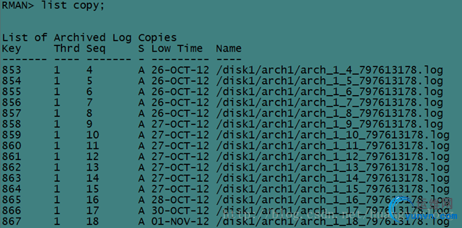

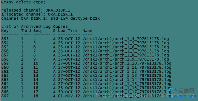

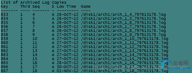

RMAN> list copy;
RMAN> delete copy;
deleted archive log
archive logfilename=/disk1/arch1/arch_1_4_797613178.log recid=853 stamp=797680899
deleted archive log
archive logfilename=/disk1/arch1/arch_1_5_797613178.log recid=854 stamp=797680902
deleted archive log
archive logfilename=/disk1/arch1/arch_1_6_797613178.log recid=855 stamp=797680911
deleted archive log
archive logfilename=/disk1/arch1/arch_1_7_797613178.log recid=856 stamp=797686101
deleted archive log
archive logfilename=/disk1/arch1/arch_1_8_797613178.log recid=857 stamp=797765967
deleted archive log
archive logfilename=/disk1/arch1/arch_1_9_797613178.log recid=858 stamp=797769330
deleted archive log
archive logfilename=/disk1/arch1/arch_1_10_797613178.log recid=859 stamp=797779367
deleted archive log
archive logfilename=/disk1/arch1/arch_1_11_797613178.log recid=860 stamp=797781258
deleted archive log
archive logfilename=/disk1/arch1/arch_1_12_797613178.log recid=861 stamp=797782326
deleted archive log
archive logfilename=/disk1/arch1/arch_1_13_797613178.log recid=862 stamp=797785426
deleted archive log
archive logfilename=/disk1/arch1/arch_1_14_797613178.log recid=863 stamp=797786840
deleted archive log
archive log filename=/disk1/arch1/arch_1_15_797613178.logrecid=864 stamp=797852200
deleted archive log
archive logfilename=/disk1/arch1/arch_1_16_797613178.log recid=865 stamp=798037031
deleted archive log
archive logfilename=/disk1/arch1/arch_1_17_797613178.log recid=866 stamp=798242772
deleted archive log
archive logfilename=/disk1/arch1/arch_1_18_797613178.log recid=867 stamp=847641900
Deleted 15 objects

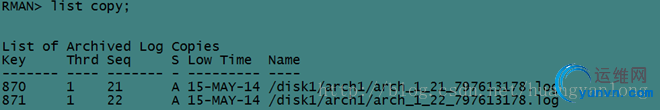

RMAN> list copy;
specification does not match any archive log inthe recovery catalog

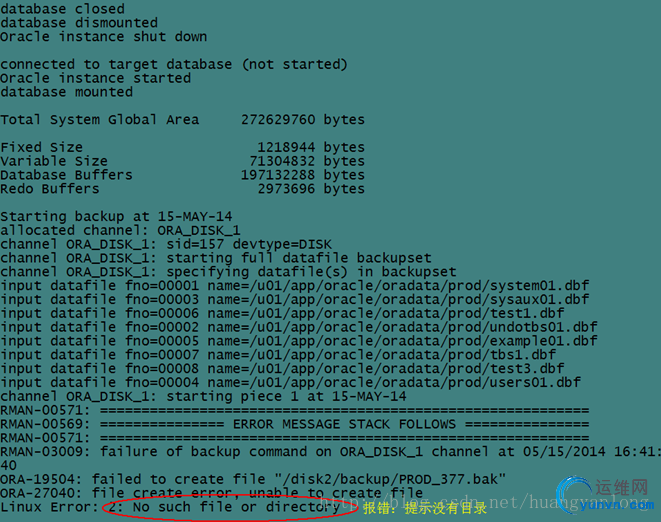

RMAN> quit
[oracle@rh55 ~]$ mkdir -p /disk2/backup
Recovery Manager: Release 10.2.0.1.0 - Productionon Thu May 15 16:51:57 2014
Copyright (c) 1982, 2005, Oracle.  All rights reserved.
connected to target database: PROD(DBID=199802235, not open)
注意:先不要按下面执行,先看看后边的“更正”!
RMAN> run{
2> shutdown immediate;
3> startup mount;
4> backup database format '/disk2/backup/%d_%s.bak';
5> alter database open;
6> }
using target database control file instead ofrecovery catalog
database dismounted
Oracle instance shut down
connected to target database (not started)
Oracle instance started
database mounted

更正:由于之前已经处于mount状态,直接执行备份语句即可,如下所示:
RMAN> backup database format '/disk2/backup/%d_%s.bak';

Starting backup at 15-MAY-14
channel ORA_DISK_1: sid=157 devtype=DISK
channel ORA_DISK_1: starting full datafile backupset
channel ORA_DISK_1: specifying datafile(s) inbackupset
input datafile fno=00001name=/u01/app/oracle/oradata/prod/system01.dbf
input datafile fno=00003name=/u01/app/oracle/oradata/prod/sysaux01.dbf
input datafile fno=00006 name=/u01/app/oracle/oradata/prod/test1.dbf
input datafile fno=00002name=/u01/app/oracle/oradata/prod/undotbs01.dbf
input datafile fno=00005name=/u01/app/oracle/oradata/prod/example01.dbf
input datafile fno=00007name=/u01/app/oracle/oradata/prod/tbs1.dbf
input datafile fno=00008name=/u01/app/oracle/oradata/prod/test3.dbf
input datafile fno=00004name=/u01/app/oracle/oradata/prod/users01.dbf
channel ORA_DISK_1: starting piece 1 at 15-MAY-14
channel ORA_DISK_1: finished piece 1 at 15-MAY-14
piece handle=/disk2/backup/PROD_380.baktag=TAG20140515T170725 comment=NONE
channel ORA_DISK_1: backup set complete, elapsedtime: 00:00:34
Finished backup at 15-MAY-14

RMAN> list backup;
RMAN> list copy;
RMAN> alter database open;          //开库
RMAN>quit

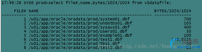

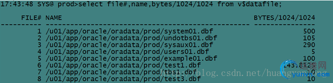

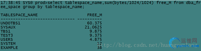

17:38:45 SYS@ prod>select tablespace_name,sum(bytes/1024/1024)free_M from dba_free_space group by tablespace_name;     //查看各表空间剩余量
17:43:37 SYS@ prod>col name for a50

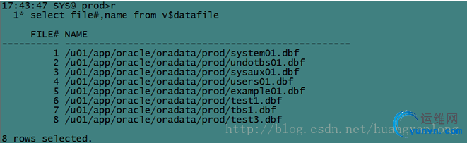

17:40:13 SYS@ prod>select file#,name from v$datafile;    //查看数据文件号
17:43:48 SYS@ prod>select file#,name,bytes/1024/1024 fromv$datafile;
//查看数据文件大小,根据上面查询出的表空间剩余空间对其进行相应调整
17:46:04 SYS@ prod>alter database datafile 1 resize 700m;    //给system01.dbf扩容
17:47:09 SYS@ prod>alter database datafile 3 resize 400m;    //给sysaux01.dbf扩容
17:47:44 SYS@ prod>alter database datafile 4 resize 50m;      //给users01.dbf扩容
17:49:28 SYS@ prod>select file#,name,bytes/1024/1024 fromv$datafile;
//再次查看数据文件大小,这里因为undo启动了自动扩展功能,所以未对其进行扩容

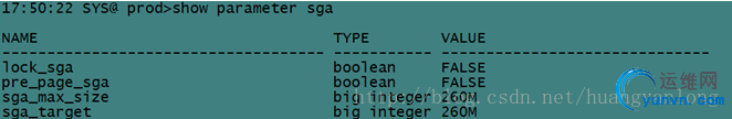

17:50:22SYS@ prod>show parameter sga      //查看sga设置情况
17:51:54 SYS@ prod>alter system set sga_max_size=600mscope=spfile;  //修改sga最大值
17:53:40 SYS@ prod>alter system set sga_target=600m scope=spfile;     //修改sga目标值

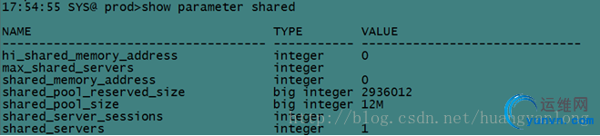

17:54:55 SYS@ prod>show parameter shared      //查看各共享池尺寸
17:55:05 SYS@ prod>alter system set shared_pool_size=200mscope=spfile;//调整共享池尺寸
17:55:41 SYS@ prod>alter system set java_pool_size=300mscope=spfile;

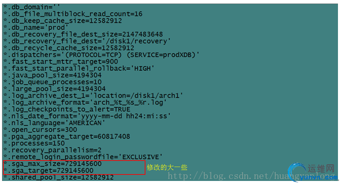

【补充】:报sga_target太小错误

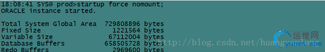

17:56:14 SYS@prod>startupforce nomount;
//由于刚刚对sga进行了扩展,致使大小已经超出初始化文件中设定的sga大小,所以报此错误
alert_prod.log           c-199802235-20120822-04  init.ora     orapwprod
alert_test1.log          hc_catdb.dat             initprod.ora  snapcf_prod.f
c-199802235-20120812-1d  hc_prod.dat              lkCATDB       spfileprod.ora
c-199802235-20120812-20  hc_test1.dat             lkPROD
c-199802235-20120812-22  initdw.ora               lkTEST1
[oracle@rh55 dbs]$ vi initprod.ora
补充完毕
[oracle@rh55 dbs]$ !sql

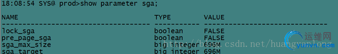

18:06:34 SYS@ prod>create spfile from pfile;
18:08:41 SYS@ prod>startup force nomount;
18:08:54 SYS@ prod>show parameter sga;

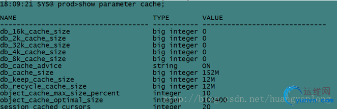

18:09:21 SYS@ prod>show parameter cache;
18:09:47 SYS@ prod>show parameter disp;

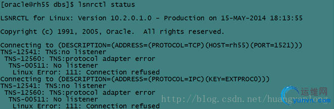

(7)查看监听状态
确保监听处于停止状态
[oracle@rh55 dbs]$ lsnrctl status      //查看监听状态
//查看所有相关端口已经关闭
[oracle@rh55 dbs]$ netstat -an |grep 1521
[oracle@rh55 dbs]$ netstat -an |grep 1158
[oracle@rh55 dbs]$ netstat -an |grep 5500

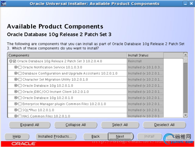

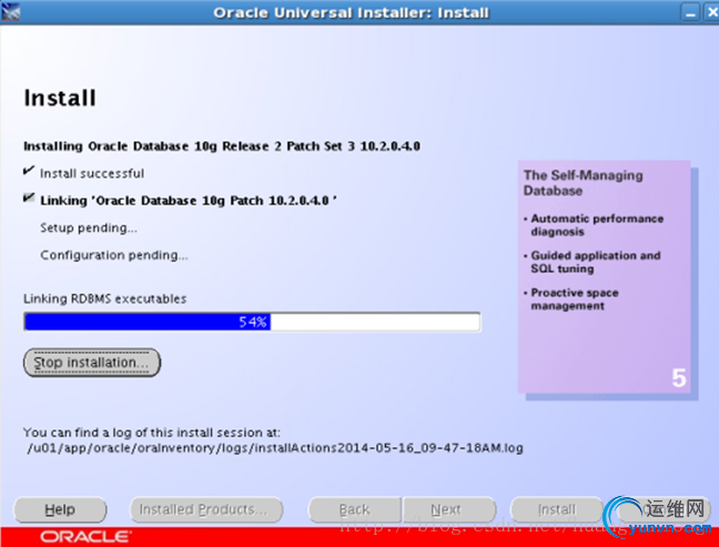

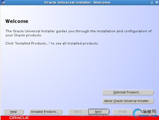

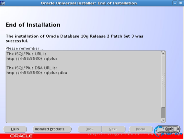

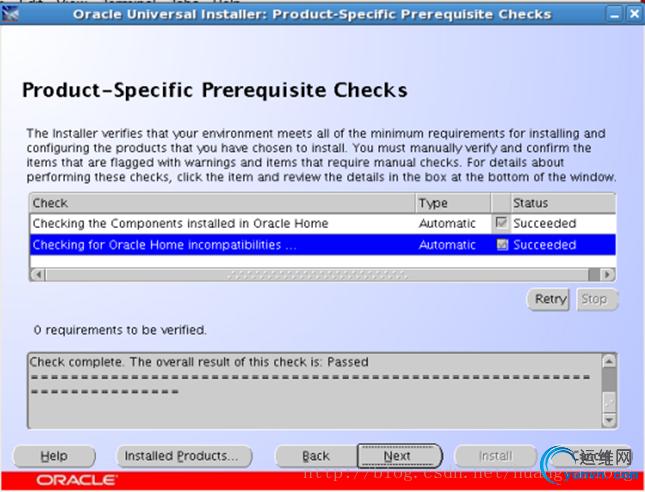

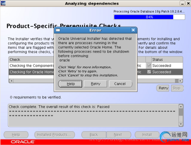

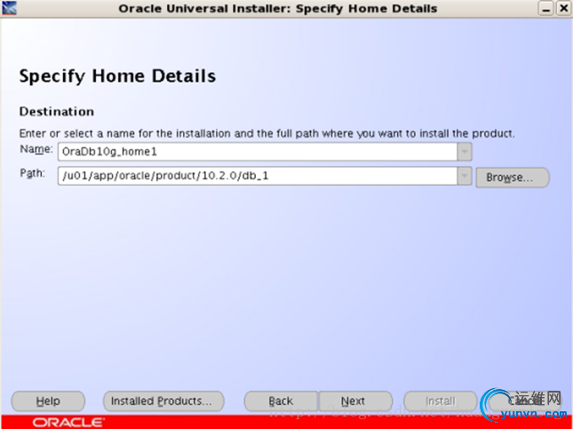

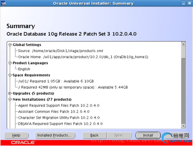

2、 升级oracle软件运行补丁包中的./runInstaller文件,参考如下图所示:
下面报错了,如下图:
重启虚拟机,再次执行以上操作,不在弹出错误提示,进入如下界面:

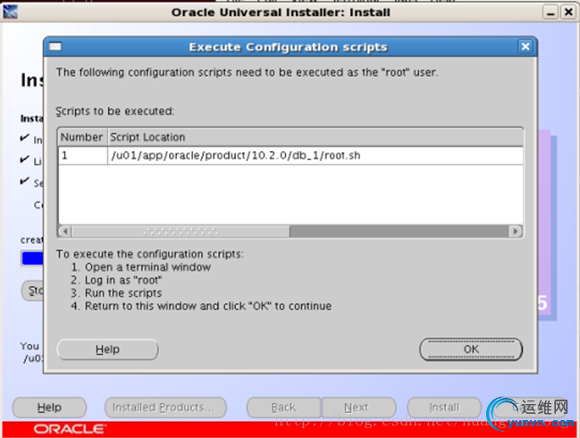

[iyunv@rh55 ~]# /u01/app/oracle/product/10.2.0/db_1/root.sh        //运行第一个脚本
Running Oracle10 root.sh script...
The following environment variables are set as:
   ORACLE_OWNER= oracle
   ORACLE_HOME= /u01/app/oracle/product/10.2.0/db_1
Enter the full pathname of the local bindirectory: [/usr/local/bin]:
The file "dbhome" already exists in/usr/local/bin.  Overwrite it? (y/n)
[n]: y
   Copyingdbhome to /usr/local/bin ...
The file "oraenv" already exists in/usr/local/bin.  Overwrite it? (y/n)
[n]: y
   Copyingoraenv to /usr/local/bin ...
The file "coraenv" already exists in/usr/local/bin.  Overwrite it? (y/n)
[n]: y
   Copyingcoraenv to /usr/local/bin ...
Entries will be added to the /etc/oratab file asneeded by
Database Configuration Assistant when a databaseis created
Finished running generic part of root.sh script.
Now product-specific root actions will beperformed.
至此,数据库软件升级完成。

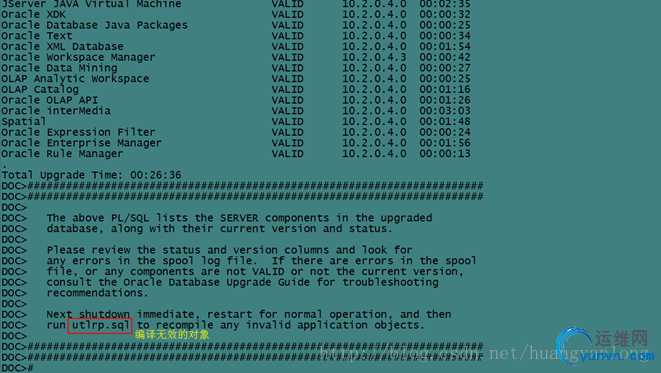

(1)升级数据字典
SQL> spool /home/oracle/cpu_up.log     //把脚本信息录入到一个日志文件中
SQL> @?/rdbms/admin/catupgrd.sql       //开始跑脚本,升级数据字典,约10分钟
//如上图,数据库字典升级脚本运行完毕
//根据提示信息,下一步关库,之后正常启库,之后运行utlrp.sql脚本

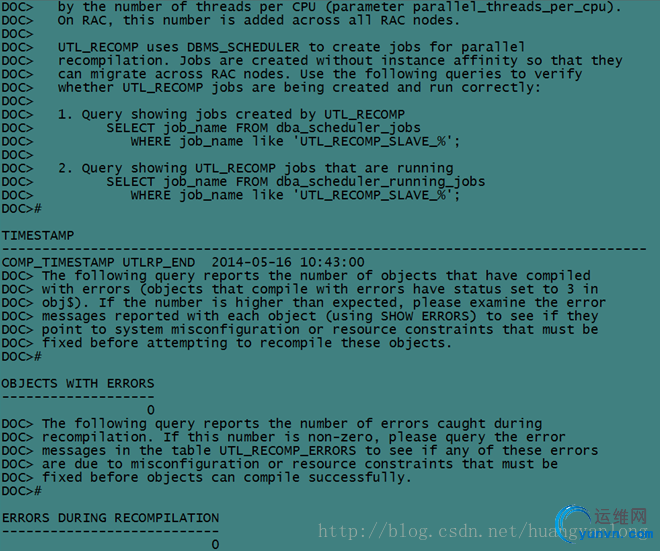

SQL> @?/rdbms/admin/utlrp.sql
//若在没有应用的情况下,运行这个脚本会比较快,约2分钟
//如上图,没有任何错误,数据库字典升级结束

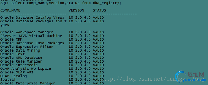

(2)查看版本升级情况
SQL> select * from utl_recomp_errors;   //检测组件升级情况
SQL> col comp_name for a30
SQL> set linesize 200
SQL> select comp_name,version,status from dba_registry;
//comp_name:组建名
SQL>show parametercomp
//compatible参数一旦被修改,数据库将无法进行回退,修改之前,一定确认所有应用在新版本上运行没有问题再去修改此参数
(3)修改兼容性参数
SQL> alter system set compatible='10.2.0.4.0' scope=spfile;
//确认应用运行无误后,修改参数compatible
至此,数据库已经由10.2.0.1.0升级为10.2.0.4.0。
