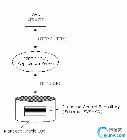

  The Database Control relies on various underlying technologies to               discover, monitor, and administer the Oracle Database environment.
  From the Database Control, you can monitor and administer a single               Oracle Database instance.
  The Database Control Framework consists of the Database Control               and its underlying technologies:
  •                  A local version of the Oracle Management Service designed to                 work with the local database or clustered database.
  •                  A local Oracle Management Repository installed in the local                 database and designed to store management data for the Database Control.

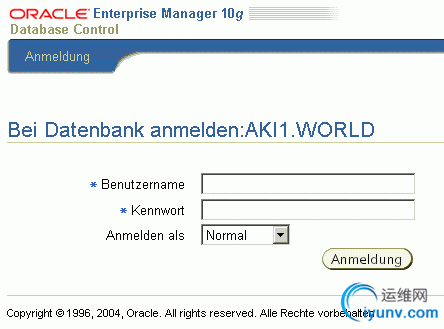

             Try to connect to the database Control
               http://akira:5500/em
               If you look at the installed schemas, you can now find the SYSMAN               schema, which is the database Control Repository.
